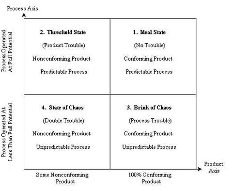

While both definitions of trouble are valid, neither one is sufficient to fully characterize a production process. Hence we need to combine these two definitions to get the full picture. When we do this we end up with four distinct categories that may be used to characterize any process. See figure 3.
1. Conforming product and a predictable process (no trouble)
2. Nonconforming product and a predictable process (product trouble)
3. Conforming product and an unpredictable process (process trouble)
4. Nonconforming product and an unpredictable process (double trouble)
Figure 3: The four possibilities for any process

The new mantra
It is important to operate a process to meet requirements. But the fact that some processes are operated up to their full potential, while others are not, makes the issue of operating to meet requirements more complex than the traditional wisdom of upgrading the bad processes and ignoring the good processes.
Traditional process upgrades are focused on moving from the left side to the right side, as shown in figure 5. Operating a process up to its full potential is focused on moving from the bottom to the top, as in figure 5. Economic operation requires that we do both.
Thus, when we combine the two definitions of trouble we end up with a new mantra for improvement. The new mantra may not be as simple as the original mantra, but it does a much better job of reflecting reality and describing appropriate courses of action.
The new mantra:
Find assignable causes for unpredictable processes and remove their effects;
Upgrade or adjust predictable processes in the Threshold State; and
Ignore or tweak the predictable processes in the Ideal State.
The first line of this new mantra defines how to operate your process with minimum variance. When a process is operated on target with minimum variance it is operating up to its full potential. The second line deals with what you have to do when that is not enough. Thus, this new mantra is one that will guide you through the complexities of improving an existing process. It uses the four possibilities as a matrix to triage your process improvement efforts.
Figure 5: The basis for the new mantra of process improvement
