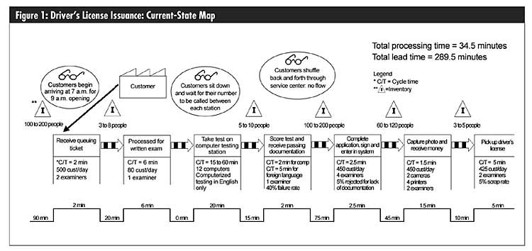

When each activity has been observed and the team feels good about the data it's collected, the current-state map can be constructed. Each activity should be labeled in a process box, and the data for that activity listed below it. Arrows should be used to show the flow of the product, and triangles between the process boxes can be used to depict inventory levels of work in process before each activity. Icons and arrows showing communication flows--whether they're electronic, manual, visible or something else--are drawn opposite the product flow, because they signal upstream activities that will react to downstream information. For an example of a typical current-state map, see figure 1.
Finally, a sawtooth diagram should be drawn underneath the value stream to depict process and lead time. The diagram's upper teeth should be drawn under process boxes that depict activities in the value stream. The time to process a single unit of product should be written on each of these teeth. The lower gaps of the sawtooth diagram should be drawn between process boxes where inventory is represented in the value stream. This is where queue time is shown in the value stream and can be calculated using a days-of-inventory method or by other means where necessary.
Once the current-state map is drawn, the process time for the value stream can be calculated by adding the times along the upper teeth of the sawtooth diagram. The total lead time is calculated by adding all the times on the upper teeth and the lower gaps together. Often, the process time in the value stream will be less than five percent of the total lead time.

A case study
Figures 1 and 2 depict current-state and future-state examples of how a VSM can be applied in a service industry. In this case, a common service that many of us dread--driver's license issuance--is developed using the flow of a customer needing to take a written test to receive a license. Embedded in this value stream are the basic services of renewal, replacement, and name and address changes.
Following the completion of VSM steps one through five, the team that developed the current-state map brainstormed the following improvement initiatives:
Develop a creative staffing plan that allows for extended hours to eliminate a deluge at the beginning of the day.
Develop written instructions in multiple languages detailing exactly the forms and documentation needed for each service a customer may need.
Redesign the application forms for easier understanding and create a desk with template examples where customers can fill out their own paperwork.
Create online practice exams in multiple languages.
To decrease the failure rate, charge for a second test attempt.
Provide computer-based testing in multiple languages, eliminating paper and pencil testing and manual scoring.
Install one more camera at the photo station to keep up with demand.
Develop a first-in, first-out line for photos and license receipt to prevent customers from sitting and returning to the process.
Redesign the layout of service centers to eliminate confusion and create a continuous flow of customers.
Create a one-stop help desk for customers who have unusual circumstances so they don't disrupt the flow.
These improvement initiatives are only a few of the ideas developed to improve the value stream for driver's license issuance. There are many small improvements that form during a VSM event that can also be implemented quickly.
Clearly, there are many more options to further improve the future-state map. This future state accomplished two goals of VSM and lean techniques. First, the improvement initiative strategy was created with a six-month time frame and the improvements that were called for were doable in this time period. Second, the team focused on improvements that were of little or no cost. This is a key learning point within lean systems: Avoid significant investment in capital until the process can't be improved without it.
