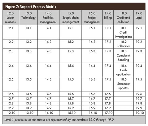

The hospital has eight support business processes, as listed in figure 2. A support process better enables core processes to create value to customers; support processes don't contribute directly to the primary product or service.
