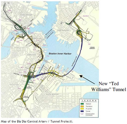

As you know I live outside of Boston. Going to the airport always involved driving in downtown Boston (20 minutes in the average process time along with a lot of variation). Downtown Boston is known for its small one way streets, notoriously poor roadway signs, traffic, and the Big Dig. Part of the Big Dig project was to create a two-mile tunnel that connects the toll road to the airport, which allows you to bypass downtown Boston. When the Ted Williams Tunnel (figure 3) opened up in January 2003, it immediately eliminated the need to drive through downtown traffic. It reduced my trip time by 20 minutes (on average). The much bigger benefit was that this process change significantly reduced the trip time variation.

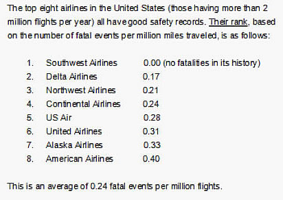

The airline industry example in figure 5 below exposes us to the fact that not all processes have to be 99.999-percent perfect. I am sure the quality of baggage handling doesn’t meet your expectations since we have all lost a bag during our travels. But the airline industry does boast a 99.99998-percent (six nines) quality level safety record based on the number of fatal events per million.
Figure 5: Airline safety record

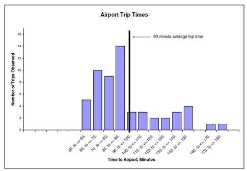

Figure 6 below is a histogram of my airport trip information. It’s the same 58 trips, now sorted by the length of time of the trip.
Figure 6: Histogram of trips sorted by length of time
What does the chart tell us? The good news is that the data is starting to tell us more about the distribution of data around our average trip time. In fact, it shows us that our trip is never less than 50 minutes and those 36 trips were actually less than our average time! We can also see a few very bad trip times of more than 170 minutes (almost three hours). But the problem still remains. How much time should I plan for the trip? Well the good news is that we know more about the data. We all know that Saturday morning will have less rush hour traffic. We also know that during the week, we can work around the rush hour by leaving early. So let’s create one more chart before answering the question on how to reduce our trip time and reduce wasted time at the airport.

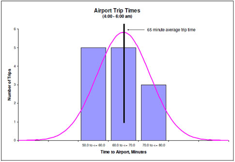

Figure 7: Trip times when leaving house between 4 a.m.and 6 a.m.
The chart above shows my trip times when I leave the house between 4 a.m. and 6 a.m. We all know that the time of day is a major source of variation in our data and this chart highlights that fact. The chart above shows that our average time to the airport, if we travel between 4 a.m. and 6 a.m. (before rush hour traffic!) is 65 minutes which is significantly less than our overall average time of 93 minutes.
