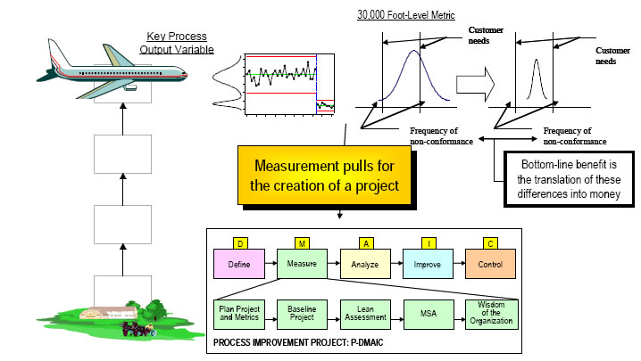

Figure 1 illustrates for continuous data how improvement metric needs can pull for a project define-measure-analyze-improve-control (P-DMAIC) road map execution, while figure 2 does the same for an attribute response.
Figure 1: Integrated Enterprise Excellence project creation, execution, and the benefits of continuous response (click for larger picture [5])
From Figure 2.7 Integrated Enterprise Excellence Volume III—Improvement Project Execution: A Management and Black Belt Guide for Going Beyond Lean Six Sigma and the Balanced Scorecard, by Forrest W. Breyfogle III (Bridgeway Books, 2008).
