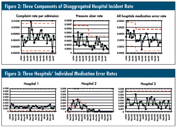

Figure 2 is a layout of three of several component graphs that disaggregates the data down to the next management level.
Now let's look specifically at the disaggregated medication error rates for three of the six hospitals that make up the aggregated "all hospitals medication error rate" from figure 2, in the format that I described in my two previous columns. These are shown in figure 3.
So, despite not triggering a signal at the board level, progress is being made in several areas that have been deemed important to the organization… as well as exposing opportunities for ongoing improvement. If the board is frustrated by the lack of progress shown in their chart, because of the common language, they can request the sub-scorecards and get a pleasant surprise, or appropriately request resources for areas that seem stuck.
