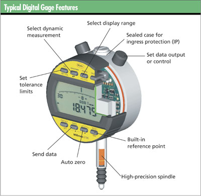

Today’s feature-packed indicators al-so allow users to choose the best resolution for their gaging requirements. One common application error is caused by having too many digits visible on the display. Flickering digits make the gage look unstable and can confuse the operator. Keep in mind that more digits don’t mean better measurements. Turning off the extra digit stops the flicker and simplifies reading. Matching resolution to the gage performance just makes the user’s job easier.
A number of features included in newer gages are designed to take guesswork away from the operator. These include:
Preset features. These place the actual part size on the display so the operator can match the print to the indicator.
Tolerances. By allowing the display to classify the part, operator influence can be reduced. Tolerance can be set as balanced or unilateral (i.e., on both sides or one side). Thus, with an indicating symbol, the operator can easily see whether the part is good or bad. Many digital indicators also incorporate colored displays--i.e., green when the part is good, red when it’s out of spec.
It’s important to lock out these changeable features. Nothing is worse than nimble fingers sneaking in and changing these flexible features in process. Through passwords, special programming keys or remote setup by computer, these features can be locked out. This makes the digital indicator almost like an analog one: purpose-built or set up for an application, although in this case, the electronics can be changed later. The operator sees what he or she needs to but isn’t tempted to make changes.
Finally, some indicators come with multiplication factors. Often used with three-point gaging, levers and such, these indicators have selectable multiplication factors built in for these applications.

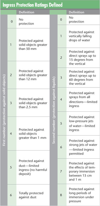

A new standard has been set up to help identify what type of tool is best for the environment in which it will be used. This rating is called ingress protection (IP). Associated with the IP is a two-digit rating number that tells what type of conditions the gage can survive in. The first digit describes the protection factor for solid foreign objects, while the second digit indicates protection against harmful ingress of water. A third digit, which is the defined impact protection, hasn’t yet made its way into the measuring instrument table, which is detailed in the figure on the following page.
For example, a gage with a rating of IP-65 is totally protected against dust and low-pressure jets of water from all directions, with limited ingress permitted. Today there are calipers and micrometers with ratings as high as IP-67. These can be subjected to the type of dust and dirt found in the shop and are both water- and coolant-proof.
