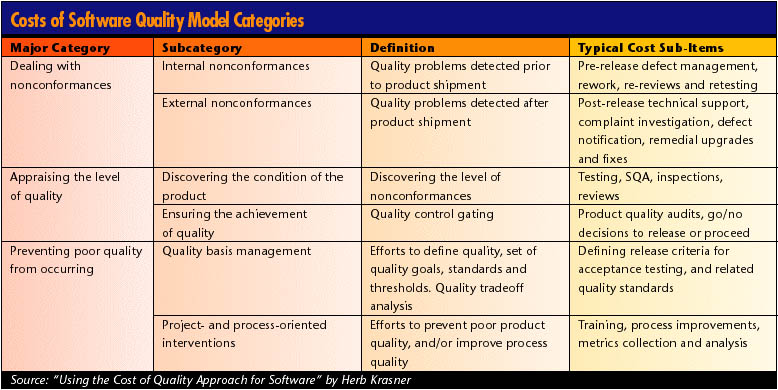

The cost of software quality
There are several approaches a software developer can take when implementing quality practices. Krasner has developed an approach called the "cost of software quality," which outlines the economic benefits of delivering good quality software. The cost of quality approach has long been used in the manufacturing industry, and Krasner has expanded on that idea to include software development.
CoSQ defines key dimensions of software quality, including the level of customer satisfaction; the degree to which software has value for its stakeholders; key attributes such as reliability, usability and maintainability; the degree to which a software product is defective and the implementation of quality processes. (See page 34.)
In his report, "Using the Cost of Quality Approach for Software," Krasner explains that companies need to answer three questions: How much does poor software quality cost? How much does good software quality cost? How good is our software quality? Once these questions are answered, the software providers can compare quality costs to overall software production costs and software profits, compare quality costs to benchmarks and norms, better analyze product quality to improve their competitive situation, measure improvement actions and bottom-line effect of quality programs, visibly see previously hidden costs related to poor quality, and more clearly see the economic tradeoffs involved with software quality.
"By putting the cost of quality model into action in an organization, what immediately becomes obvious to management and the executives is the amount of money they're losing on fixing bugs and delivering poor-quality products," comments Krasner. "They were never able to quantify that before, so they could only guess about how it was affecting their bottom line. The cost of quality model gives them results in a form that they understand: dollars."
