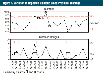

Over the next several years, I monitored my blood pressure as I experimented with ways to bring it down. In Figure 1, The R chart indicates the variation between multiple readings taken on the same day. The average and control limits zigzag because sometimes I checked my blood pressure twice and sometimes three times on a given day. According to the R chart, if I check my blood pressure twice in one day, I can expect to see an average difference of about five points and a maximum of about 15. If I check it three times, the average difference will be about seven points with a maximum of about 17 points.
