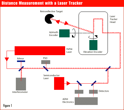

Operationally, a laser tracker is easy to understand: It measures two angles and a distance. The tracker sends a laser beam to a retroreflective target held against the object to be measured. Light reflected off the target retraces its path, re-entering the tracker at the same position it left. Retroreflective targets vary, but the most popular is the spherically mounted retroreflector. As light re-enters the tracker, some of it goes to an interferometer that measures the distance from the tracker to the SMR.
Figure 1 shows the path from a helium-neon laser to the retroreflector and back into the interferometer. Also shown are the angular encoders. These devices measure the angular orientation of the tracker's two mechanical axes: the azimuth axis and the elevation axis. Measuring the encoders' angle and the interferometers' distance is sufficient to locate precisely the SMR's center. Tracker software applies an offset equal to the SMR radius to obtain the coordinates of the scanned surface.
Distance measurement, an important function of the laser tracker, can be either incremental or absolute. An incremental distance measurement is made with an interferometer and a frequency-stabilized, helium-neon laser. The laser light splits into two beams. One travels directly into the interferometer. The other beam travels out of the tracker, reflects off the SMR and, on the return path, passes into the interferometer. Inside the interferometer, the two beams of light interfere, resulting in a cyclic change each time the SMR moves closer to or farther from the tracker by a distance equal to half the light's wavelength (~0.3 micron). Electronic circuitry counts the cyclic changes (known as "fringe counts") to determine the distance traveled.
In a typical measurement sequence, the operator places the SMR in the tracker's home position and resets the interferometer to the known (i.e., home) distance. As the operator moves the SMR to the desired location, the laser tracks along, remaining fixed to the SMR's center. This procedure works well as long as the beam from the tracker to the SMR isn't broken by an obstruction in the beam path. If the beam is broken, however, the number of counts is no longer valid and the distance isn't known. When this happens, the tracker signals that an error has occurred. The operator must then return the SMR to a reference point, such as the tracker's home  position.
Absolute distance measurement capability has been around for years. Within the last two years, however, ADM systems have undergone dramatic improvement, offering accuracy comparable to interferometers. The advantage of ADM mea-surement over incremental distance measurement is the ability simply to point the beam at the target and shoot. The ADM system measures the distance to the target automatically, even if the beam has previously been broken. Infrared light from an eye-safe semiconductor laser reflects off the SMR and re-enters the tracker, where it's converted into an electrical signal. Electronic circuitry analyzes the signal to determine its time of flight, multiplying this value by the speed of light in air to determine the distance from the tracker to the SMR.
Another tracker function is beam steering and control. An SMX tracker steers the laser beam by sending it through glass prisms attached to the mechanical axes. By rotating the axes, the tracker can point the laser beam in any desired direction. With most applications, having the tracker point the beam in a particular direction is necessary but insufficient; the tracker also must keep the beam centered on a rapidly moving SMR. To accomplish this, part of the reflected laser beam splits off to a position-sensing detector, as illustrated in Figure 1. If the laser beam strikes the SMR off center, the split-off beam also strikes the PSD off center, creating an error signal. This signal controls the mechanical axes' rotation to keep the beam centered on the SMR.
