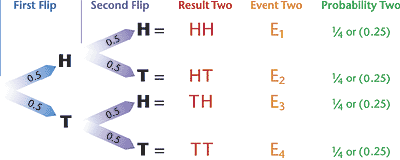

While Simsack contemplates the imprint of his shoe on the carpet, Deviation reminds the class of the multiplication rule he had presented last week using a flip of a coin (which we reviewed in June's column):
He then asks the class what the probability of getting two heads would be. They respond one-fourth (0.25). When he poses the question of probability of two tails, they respond the same way.
P(A and B) = P(A)(B) or P(T and T) = P(T) x P(T)
Reminding them that this is the multiplication rule, he asks what the probability of one head and one tail might be. One brave student notes that this could happen in two ways (E2 or E3) or HT or TH. Using the same logic, she says if those separate events have a one-fourth (25%) probability, then the answer would be 50 percent. The professor smiles because he's just presented the addition rule:
P(A or B) = P(A) + P(B) or
P(one head & one tail) = P(HT) + P(TH)
Thus, the trimodal distribution is now explained. The center mode of trimodal distribution is made up of samples that are from right left and left right.
