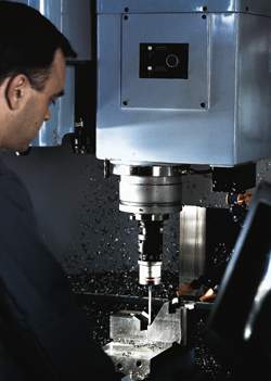

Machine-mounted touch probes
The machine-mounted touch probe system represents another cost-effective meas-urement solution for closed-loop process control. Unfortunately, quality control managers often reject out of hand this highly practical measurement technology because it relies on the machine's coordinate feedback system to produce its measurement readings. Many quality control people can't accept the concept of meas-uring a part on the same machine that makes it. And they have a point -- if they plan to take a measurement, plot the data on a chart and do an SPC analysis. Because its measurements can be no more accurate than the machine tool's positional accuracy, touch probes are not recommended for on-machine applications where size data must be extremely precise.
However, if the purpose is to control the machining process, a touch probe can meet the requirements at a far lower cost than alternative hard-gaging systems. With a locational repeatability of better than 40 millionths of an inch (0.00004"), it will successfully control any process where the dimensional tolerances to be maintained are no tighter than 0.001". What's more, when programmed correctly, the touch probe system offers as much flexibility as the CNC machine on which it is used. Generally, the system will provide process control for any parts that can be cut within the machine tool's work envelope.
Closed-loop process control based on statistical monitoring and trend retargeting can be economically achieved on CNC lathes using a turret-mounted touch probe for post-process parts inspection. In these applications, the probe measures the part's critical dimensions after it is machined to determine where each dimension falls within programmed, statistically based process limits. The probing software then uses its statistical capabilities to analyze this information and make a compensation decision.
