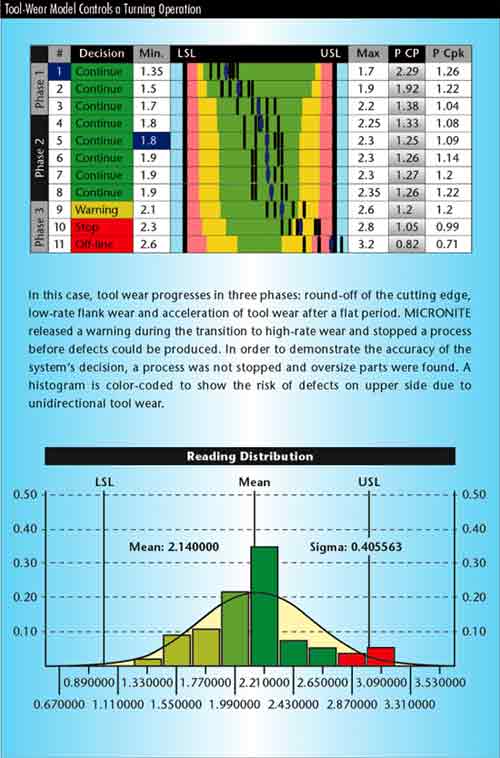

Typically, a tool-wear curve consists of small, steep slopes of irregular duration within a single tool lifespan: Cutting-edge round-off and initial flank wear are low-rate processes, but, in the latter stages of tool wear, flank wear and cratering might be a high-rate process. Tool wear in an ideal metal-cutting process progresses in three phases: round-off of cutting edge, low-rate tool wear and transition to high-rate tool wear. The duration of each phase isn't repeatable even in the most stable process conditions. Multiple sources of variation on the cutting or forming edge change the tool wear curve every time an insert is indexed or a form tool is sharpened.

MICRONITE uses three types of predictive models: nonlinear trend control, control of probability of defects and control of extent of tool wear. Because sampling time is critical, adaptive intervals for every tool are updated after each data entry. The system also allows predetermined levels of product variation. Real-time control by a CpK model (without using X-bar and R charts) guarantees a customer-required variation index.

A workstation is located near a machine, a group of machines or a cell. Upper and lower specification limits are entered for each dimension, as is the cycle time for each cutting operation. Based on the tool-wear model, the number of parts run and other parameters, the software prompts the user to measure a unit or sample. The software then tells the operator to continue, input a compensation adjustment into the machine or change the tool. It will also tell the operator how long before the next measurement must be taken. The software adapts the model as new data is collected and analyzed.
Here's an oversimplified description of what actually occurs. First, a process (i.e., tool wear) curve is segmented in real time by one of iPACT's rule-based models. After every data entry (either sample or unit), a model predicts the risk of defects until the next inspection, the rate of tool wear related to the location of data averages, and sample variation. If the system determines that a risk of defects has increased, a compensation adjustment will be recommended; if tool-wear rate has dangerously increased, a tool change is advised (See figure).
A trend control model will stop a process at the point of accelerating tool wear and increased risk of defects. A model controlling the extent of tool wear will stop a process before severe tool deterioration occurs. Stable processes with relatively low tool-wear rates are controlled by separate estimates of the probability of defects on the lower and upper specification limits. Sampling time is critical and is adjusted dynamically after each measurement; a stable process with little variation would require a longer sampling interval than a process with large variation and high-rate tool wear.
