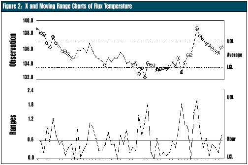

A traditional X and R chart or X and moving range charts won't work with data like that shown in Table 1. Figure 2 shows the temperature data plotted as X and moving range charts. Note that the moving range chart shows statistical control, while the X chart appears out of control. That's because the temperature changes are statistically independent, although the magnitude of the overall change is determined by how often the process is checked. In other words, the amount the temperature can change in five minutes is smaller than the amount of change that can appear in an hour.
Of course, the information in the moving range chart is of limited value because it doesn't tell us what the solder flux bath temperature actually is, only how much it has changed since the last time it was checked. A gradual increase or decrease in the bath's temperature wouldn't be detected by the moving range chart alone, even though the final result might be a big change in the bath's temperature.
Let me emphasize that the process shown in Figure 2 is actually in statistical control! No special causes are affecting this process. The apparent out-of-control condition is caused by using the wrong SPC tool for this batch process.
