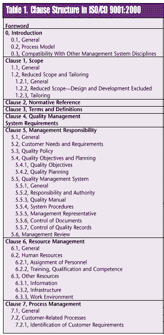

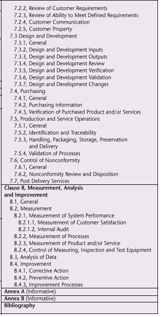

Both committee drafts have been reorganized to provide for business needs without imposing too many new requirements. (Table 1 lists the contents of ISO/CD 9001 by clause structure.) Companies already ISO 9000-registered or planning to implement a quality management system in 2000 will find the revised editions easier to understand and use.

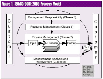

If comments submitted by TC 176 member bodies don't result in significant alterations to ISO 9001:2000's first committee draft, two related changes -- the process approach model and the new consistent-pair structure -- will affect how companies view and use the revised standard. Figure 1 illustrates the process model contained in both committee drafts.
The model focuses on two cycles for developing, outputting and using products and/or services. The first cycle comprises an organization's internal processes and is represented in Figure 1 by management responsibility (Clause 5 of ISO/CD 9001) and resource management (Clause 6), which feed into process management (Clause 7).
Process management also is subject to the second cycle, input and output, which involves customer interaction. This cycle provides companies with product or service requirements as well as feedback on how well the actual products or services meet expectations.
Both cycles share measurement, analysis and improvement (Clause 8), which serves as a feedback loop for extracting information from customer responses as well as from all activities relative to an organization's QMS.
Thus, the process approach embodied in ISO/CD 9001 emphasizes actual activities of companies using ISO 9001-based QMSs that result in products or services intended for customers.
Figure 1 also contains a Plan' Do'Check'Act cycle within the internal loop where measurement requirements lead back to management responsibility. A QMS in conformance with ISO 9001:2000 must establish a baseline against which processes can be measured.

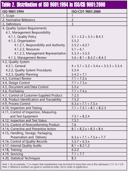

Table 2 (Annex A in ISO/CD 9001) indicates where the requirements contained in ISO 9001:1994's 20 clauses appear in ISO/CD 9001's nine clauses. For organizations currently registered to ISO 9000, Annex A may prove the most valuable implementation and maintenance aspect of ISO 9001:2000. It will permit them to preserve their current QMS documentation and make adjustments as needed by new or altered requirements.
