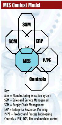

MES technology has become a key element for enterprise solutions. The system provides a central information hub of 11 decision-based functions that link to other databases. These elements, combined with an enterprise resource planning system and a control system such as PLC, SCADA, MMI or HMI, provide the means for a paperless factory. Currently, companies in the aerospace, automotive, semiconductor, pharmaceuticals and petrochemical industries have adopted MES.
In essence, a full MES solution bridges the gap between the production/assembly floor and engineering, accounting, production control, purchasing, configuration management, quality, manufacturing engineering, process engineering, research and development, and testing. MES functions as the central depository for data distribution and collection for all other enterprise systems.
