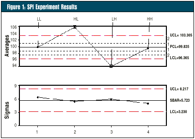

Let's say you're a process operator, and you think changing variables a and b might improve the process. You determine that both variables will run at "high" and "low" levels, and you decide to run 25 parts with a and b low (LL), which is the "normal" level. Then you run 25 more parts with a high and b low (HL), then 25 with a low and b high (LH), and finally 25 with a and b both high (HH). The results of such an experiment are shown on the X and sigma chart in Figure 1.
Spc
The sigma chart indicates that the dispersion of the process remained stable despite the changes made to a and b. However, the process average changed, as shown on the averages chart. Running a high and b low increased the average by about five or six compared to normal. Running b low and a high decreased the average by five or six. Finally, when both a and b are set to their high levels, the process operates about the same as normal.
What to make of these results depends largely on economics and engineering considerations. What will it cost to set a and b to the different levels? Do we want results higher or lower than normal? If we are shooting for maximum stability at a target of 100, then the results tell us we can run either LL or HH and get the desired result.
In other words, although we still don't know how to decrease variability, we learned a lot about this process by conducting the experiment. And we didn't need anything fancier than control charts to do it.
