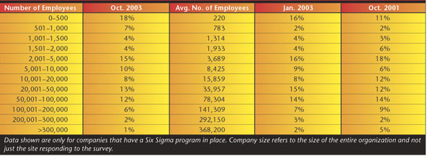

Since our first survey, Six Sigma has made some progress into small businesses, which we defined as organizations with 500 or fewer employees. In 2002, only about 11 percent of companies that had a Six Sigma program in place had 500 or fewer employees; today the portion is 18 percent. The majority of these sites, however, are part of larger organizations, indicating deeper pockets and the ability to support the program.
That said, many consultants are developing training materials or off-site courses that are more cost-effective for small companies. In addition, some small companies are implementing Six Sigma without using a full-time Six Sigma practitioner--one of the major ongoing costs for implementation.
Six Sigma programs are also making their way into their organizations’ nonmanufacturing functional areas. Although the percentage of respondents reporting that manufacturing use of Six Sigma has remained the same, at about 82 percent, almost every other functional area has shown a 3 to 5 percent increase in Six Sigma use.
Distribution of Six Sigma Programs by Functional Area
As in previous surveys, we continue to see a dramatic drop-off of companies using Six Sigma around year three. Last year we postulated that this could be because after three years, companies had reaped the predominate benefits from Six Sigma by picking the low-hanging fruit--obvious waste or productivity issues--and then lost momentum later when the dramatic savings of earlier projects failed to appear. But with only data from two surveys to consider, it was difficult to make a solid conclusion that this is the case. With this survey showing the same drop at year three, it’s becoming more apparent that many companies are abandoning the process at that point for some reason.
Strangely, although we see Six Sigma making it’s way into small companies and nonmanufacturing areas, as a whole, there are fewer companies starting Six Sigma initiatives. We define a Six Sigma start-up as a company that reports its Six Sigma initiative to be less than 1 year old. In 2002, 30 percent of respondents reported using Six Sigma for less than one year. In January of 2003 the percentage dropped to 21 percent, followed by 18 percent this year.
In addition, there is an interesting trend developing with respect to the percentage of companies within each year range across the three surveys. The percentage of companies in years one through three of implementation have dwindled each year, while the percentage in years four and higher have increased. This trend suggests that the Six Sigma market may be peaking or has peaked. However, as with last year, about 50 percent of respondents who haven’t already implemented Six Sigma said that their companies plan to start the program within the next 18 months. Next year’s survey will give us a better indication of how the Six Sigma market is progressing.
Distribution of Company Size for Sites With Six Sigma
