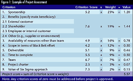

and informed judgments. Following is a short version of a sample methodology that can be used to make these judgments. Figure 1 shows a set of criteria for assessing a Six Sigma
project, along with weights for each criterion. The weights are simply my own subjective assessment of the importance of each criterion. I arrived at these weights using a software package called
Expert Choice, which I've found to be very useful in converting subjective assessments to numerical values. Expert Choice uses the analytic hierarchical process method to convert pairwise
comparisons to weights that add to 100 percent. These weights can be used in various decision matrixes, such as the one shown in Figure 1, or in quality function deployment.
![](../assets/images/pyzdek1.gif) |
Figure 1 is used by assigning a score of zero to nine to each criterion. The criterion scores are then multiplied by the weights and added together to get a total score for
the project. Project scores can range from zero to nine. Keep in mind that the numeric project score isn't as important as how it compares to other project scores.
Ideally there will be a point where some projects are clearly better than others, allowing Black Belts to pursue those projects.
To use Figure 1, you need to develop guidelines for assigning scores to each criterion. The guidelines just need to make sense for you and your organization. The
numerical scale need not be zero to nine; however, I recommend using the same numerical scale for every criterion. Using a different numerical scale amounts to
changing the weights. Figure 2 presents an example of how guidelines might look.
