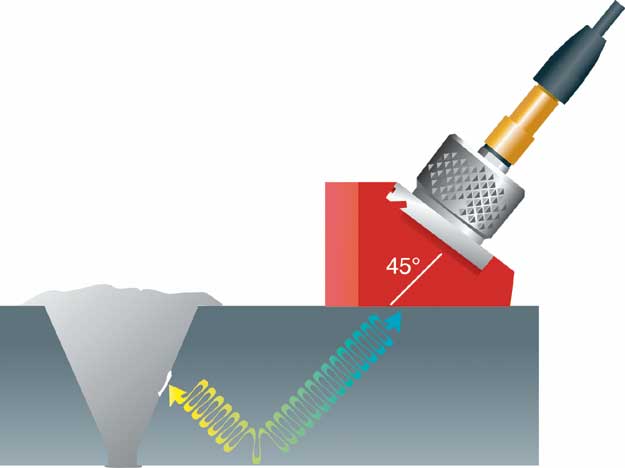

Angle-Beam Transducer Pulse Reflecting Off A Weld |

Weld inspection is the most important application for ultrasonic flaw detectors. Most contemporary digital instruments feature software designed for plotting sound
paths through welds and characterizing any suspect areas. Flaw detectors are also widely used for steam-boiler and pressure-vessel qualification, structural-steel
