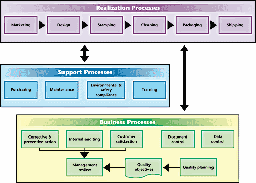

Step one: Create a process map and understand customer requirements
 Before you do anything else, study your organization. Follow the product development process and interview all personnel involved with it. To create a process map, you must identify all of your organization's key activities, from new-product development to production all the way to shipping and delivery procedures. To ensure that the process map you end up with is useful to your organization, identify all the support processes that affect your products' development and delivery, as illustrated.
 Next, determine who your customers are. Decide if the QMS you create will only support customers for your product or if it will also satisfy the requirements of all your organization's interested parties. The implications of this decision are immense. The processes needed to support these interested parties (e.g., owners/investors, lenders, personnel, suppliers/partners and the community) may result in incorporating even more processes into your process map. You'll find useful guidance and recommendations for this topic in ISO 9004:2000, clause 5.2, Management responsibility--Needs and expectations of interested parties.
It's important to understand the needs and expectations of your customers and interested parties. It will help answer the question, "What process, or set of processes, will satisfy these expectations?" In doing so, you might find that the organization actually needs to create new processes.
 Finally, check to see whether the process map includes every ISO 9001:2000 process. Do you have processes for identifying and analyzing customer expectations and needs regarding your organization's capabilities? Are there processes for capturing and analyzing customer expectations?

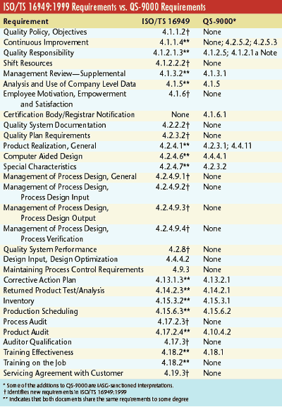

 Once you've taken the aforementioned steps, it's time to conduct an audit or gap analysis to prepare for revising your QS-9000-registered quality system to conform with ISO/TS 16949:2002's requirements. The second edition's changes to automotive requirements are minimal. So using ISO/TS 16949:1999 and ISO 9001:2000 (we recommend using ISO 9004:2000 as well) will provide you with the right criteria against which to measure your organization's QMS.
 Because your greatest adjustment will be from QS-9000 to ISO/TS 16949, we've laid out the key differences between ISO/TS 16949 and QS-9000 in the table on page 33 to show you where you need to focus. Once the gaps have been identified, your organization should develop a timing plan for implementing ISO/TS 16949:2002. This requires two methodologies. The first, the business operating system process, links customer expectations to objectives and then to key processes. The second, the process review methodology, institutionalizes continual improvement at the process level.

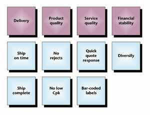

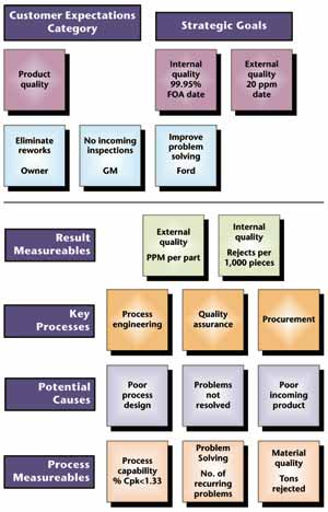

 The first step in implementing a business operating system involves identifying customer and interested-party expectations. Begin by listing, grouping and rating expectations. This allows better alignment of customers' and interested parties' expectations with processes and metrics, as shown below.
 Another key step in this methodology is using alignment charts to link each expectation category to the key processes and process measurables that must be measured and monitored to satisfy the requirements of ISO 9001:2000's clause 4.1(e) and subclause 8.2.3, Monitoring and measurement of processes.
An example of an alignment chart that would be used by an automotive supplier to satisfy critical, value-added requirements of ISO/TS 16949 and improve its QMS's effectiveness and customer satisfaction appears above.
 To satisfy ISO 9001:2000's subclause 5.4.1, Planning--Quality objectives, your organization should benchmark to determine what its short- and long-term objectives should be. Your organization's improvement plans of meeting overall objectives, per subclause 5.4.2, Quality management system planning, are accomplished by using a business operating system.
