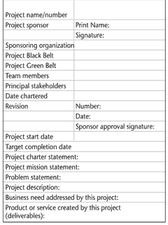

 Note that these steps are done at a high level. As the project proceeds, the project team will refine and elaborate on each of these items. The refinement will require frequent communication with the project sponsor. Project charter revisions must be documented and approved by the sponsor. Project Charters are formal documents that become part of the project plan. Table 1 should help you put together a charter for your Six Sigma project.
Table 1: Boilerplate Project Charter Document
