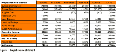

Qdbullet Project income statement. This looks forward--typically five years--at assumptions affecting income for your company (or subsidiary, division or department). Figure 1 shows these assumptions.
Fig1
The income statement follows an accrual process; that is, each anticipated expense is recorded in the period when it will be incurred. There are no secret methods involved here, simply carefully detailed research.
Assumptions affecting this income statement include:
     Depreciation. Ask your finance team member about an acceptable depreciation model for your project. Are installation costs depreciated? Which one-time costs should be specified? Figure 1 assumes a straight-line depreciation schedule.
     Service cost. This example reflects a hardware and software service agreement with the system vendor, plus an internal $3,000 per year budget for site-specific support issues. The five-year display assumes that the vendor underwrites year one service costs; years two and three are at 10 percent of the initial system cost; years four and five are at 12 percent.
Supplies cost. This is the estimated cost of consumable resources and miscellaneous, nonitemized costs.
Installation cost. This example depreciates all initial installation costs in year one. Some companies choose to bundle installation costs into a system's purchase price and depreciate the total over a longer period. Check with your finance team member.
Labor savings. Ask all team members for input. In this example, labor savings includes anticipated reductions in inventory management, scrap processing, returned goods processing, paperwork and production time required to meet output schedules.
Inventory savings. This reflects estimated direct savings in material, work-in-process and finished goods inventory gained from improved production efficiencies and yield rates.
Scrap savings. The example assumes modest improvements. Scrap savings can be huge for companies that achieve double-digit reductions from advanced SPC/ADC systems.
Supply chain savings. The new SPC/ADC system should help control the quality of goods entering your processes. This forces the defect costs back to their sources and can be a major source of savings. Figure 1 shows an extremely conservative 25 percent reduction in scrap value.
Operating income. These are accruals of all items except cost-of-money and taxes.
Interest savings. These result from reduced credit balances due to improved inventory efficiency resulting from the project.
Pre-tax income. This is how much all system-related cost reductions add to income.
Income tax. An additional tax results from additional earnings. The example assumes a 34-percent tax rate.
Net income. The total net gain that should result from successful implementation of your new SPC/ADC system.

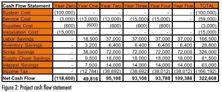

Qdbullet Project cash flow statement. Figure 2 shows what costs will be incurred and when. The year zero column shows immediate costs. The assumptions are similar to those in Figure 1, except for:
System cost. We assume the system vendor wants payment up-front.
Net cash flow. This is what is gained year-by-year. (Remember that in this statement, cash outflows, i.e. costs, are negative numbers and are shown in parentheses.)

Initial cash outlay. In this example, it's defined as system cost (per Figure 2).
Net cash savings. The same as net cash flow (per Figure 2).
Payback period. Because of a higher rate of net cash savings in year two, the initial cost of $100,000 can be recouped in just over 18 months (1.54 years).

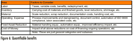

Now, quantify the savings. You and your team members who are most familiar with production and quality assurance must analyze the kinds of quantifiable savings ("hard" benefits) and intuitive savings ("soft" benefits) your proposed SPC/ADC system can deliver. Your arguments should be dramatic and convincing. In describing the need for the new system, be factual, thorough and conservative.
Figure 6 lists some hard benefits that should be relatively easy to quantify.

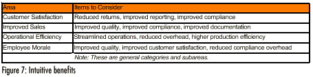

Figure 7 lists some soft benefits. Everyone may agree they are desirable but may disagree about their respective values. Keep your supporting arguments simple and noncontroversial. In some instances, it may be enough to identify benefits and discuss them briefly. Get outside validation for any definite claims you want to make.
