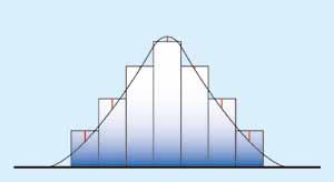

 Determining that a distribution is normal can be tricky. One method is the chi-square technique. Figure 1 illustrates a normal distribution. The red vertical lines between the histogram cells and the normal curve indicate the difference between the actual data set and the normal distribution. The data do indeed follow a normal distribution.
Figure 1: A Normal Distribution

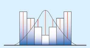

Figure 2: A Bimodal Distribution
The chi-square statistic calculates the actual difference between the data and the normal distribution. In the example, there is only a small shaded area; this would produce a small chi-square value.
 In Figure 2, a much larger difference exists between the theoretical normal and the actual data. The data demonstrates a bimodal distribution. The chi-square value would be large in this case, so it does not reflect a normal distribution. The chi-square value is calculated with this formula:
ƒa = actual frequency per cell
ƒe = expected frequency per cell
 The actual calculation of c2 is not complex, but it is somewhat unwieldy. Software is available to aid in these calculations.
