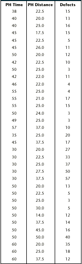

In last month's column I presented a method for conducting virtual design of experiments (VDOE) using artificial neural networks and data mining. This month I will present a manufacturing example that illustrates how this approach can be applied in the real world. Table 1: Raw Data Used to Train The data in Table 1 are from a solder process. Data weren't gathered for a designed experiment, but were merely collected during the operation of the process. Statisticians often refer to such data as "happenstance data." Because happenstance data aren't gathered under controlled conditions, they are subject to a wide variety of unknown influences that make their validity questionable. Therefore, happenstance data analysis should never be used to draw conclusions. However, because organizations usually invest substantial sums of money collecting these data, it would be a waste to ignore the information in the data warehouse just because it isn't "clean" or perfect. The data mining approach I recommend is to use the data to ask questions rather than to reach firm conclusions. The questions posed by the data mining analysis can be studied further using pilot projects and statistical design of experiments (DOE) under controlled conditions. Some examples of such questions are as follows:

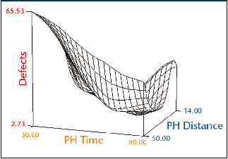

These questions can be partially answered by data mining. Artificial neural networks are just one of many possible data mining techniques that can be used. The results of the data mining provide further input into the DOE process. Figure 1: Neural Net Model

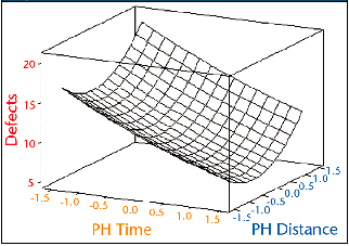

It is interesting to compare the neural net model with the response surface model (RSM) produced by classical DOE methods. The RSM is shown in Figure 2. Variable PH Time represents the circuit board preheat time in seconds, and variable D represents the distance from the preheat element in centimeters. In this Figure 2: Response Surface Analysis

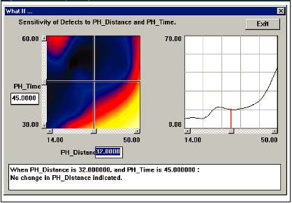

Neural net software allows "What if?" analysis, as shown in Figure 3. By using What if? you can conduct virtual DOE by designing proper experiments just as you would design real-world experiments. However, rather than using the inputs to conduct experiments on the actual process, you feed the inputs into the neural net What if? analysis. The outputs from the neural net are analyzed just as you would analyze the results of real experiments. In other words, they are entered into your DOE software, and statistical tests are made on the results. Figure 3: What If? Analysis Using the Neural Net Model
Because I created the model using happenstance data, the results must be validated. DOE methods applied to the actual process can provide the experimental validation; use the model to provide the starting point for the experiments. If the data are in fact valid, the neural network VDOE will start the experiment much closer to the optimum, thereby greatly reducing the amount of real-world experimenting required. The cost savings mean that you will be able to conduct many more experiments within your DOE budget, thus being able to make improvements more quickly. This column is based on an excerpt from The Complete Guide to Six Sigma, Quality Publishing LLC, scheduled for publication in summer 1999. Copyright © 1999 by Quality America LLC. The article first appeared at www.qualityamerica.com . Reprinted by permission.
