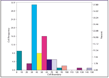

 Figure 1 shows a histogram of real data from a billing process.
Figure 1: Days between Invoice Mailing and Receipt of Payment
A control chart of days-to-pay (i.e., the number of days customers take to pay their bills) for nonprepaid invoices showed statistical control. The histogram indicates that some customers like to prepay, thus eliminating the work associated with tracking accounts payable. Customers who don't prepay tend to send payments that arrive just after the due date. There is a second, smaller spike after statements are sent, then a gradual drop-off. The high end is unbounded because a few of the customers will never pay their bills. This pattern suggests a number of possible process improvements, but the process will probably never produce a normally distributed result. Human behavior is rarely random, and processes involving human behavior are rarely normal.

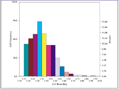

 Nature doesn't always follow the "normal law," either. Natural phenomena often produce distinctly non-normal patterns. The hot-dip galvanizing process discussed previously is an example. A metallurgist described the process to me (but too late, alas, to prevent the aforementioned debacle) as the creation of a zinc-iron alloy at the boundary. The alloy forms when the base material reaches the temperature of the molten zinc. Pure zinc will accumulate after the alloy layer has formed. However, if the part is removed before the threshold temperature is reached, no zinc will adhere to the base metal. Such parts are so obviously defective that they're never made. Thus, the distribution is bounded on the low side by the alloy-layer thickness, but (for all practical purposes) unbounded on the high side because pure zinc will accumulate on top of the alloy layer as long as the part remains submerged. Figure 2 shows the curve for the process--a non-normal curve.
Figure 2: Distribution of Zinc-Plating Thickness

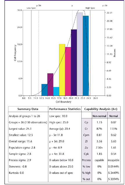

 Let's look at what happens when we try to perform a standard process capability analysis on a non-normal distribution. Suppose our data consists of measurements from a shearing operation. The specification calls for a specific dimension to be between 10 units and 23 units. A process capability analysis shows an in-control X-bar and R chart for 26 subgroups of five units per subgroup, and no parts are out of tolerance. The data distribution is shown in Figure 3.
Figure 3: Capability Analysis of Non-Normal Data
Table 1: Grouped Frequency Table
If you run a process capability analysis on this data while assuming a normal distribution, you'll get a Cp of 0.87 and a Cpk of 0.54. This means that you should expect to see more than 5 percent of parts rejected--but our raw data doesn't bear this out.
 The lesson here is that it's counterproductive to use statistics by rote, blindly plugging numbers into formulas and accepting the results. Plot a histogram of the data after you've attained statistical control, and think about how the histogram pattern relates to the real world. In this case we would expect a non-normal distribution. The upper limit is bounded by the distance from the blade to the backstop (you can't cut a piece bigger than this), and the lower limit is bounded by zero. The process should be off-center to the high side because the pieces are likely to come off the backstop only a small amount.

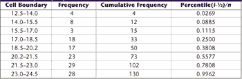

 In our example, the raw data were used to create a grouped-frequency table (see Table 1).
 For those interested in the math, the best-fit Johnson curve family was found by hand using the method described in Slifker and Shapiro.1 A four-parameter Johnson Sb curve was fitted to the grouped frequency data, providing the estimates:

 The Johnson Sb family is bounded on the low side by e and on the high side by e + l . With our data, this means that the process shouldn't produce anything less than 14.228 or greater than 24.3864 units in size. The upper bound has a physical explanation: the backstop of the shear. The lower bound is simply the result of mathematics; nothing prevents the shear operator from allowing the piece to come off of the stop further. In fact, there were three values below the "lower bound." (This was not the case with the lower bound found via the more accurate computer method, which follows.)
 Because the bounds are both within the specification limits of 10 to 25, we expect a yield of virtually 100 percent from this process, and that's what we get. Computing the capability indexes is a bit tricky. Because both of the specifications are beyond the bounds of the fitted curve, it's impossible to compute Cpk. Even if we could compute Cpk, deciding on which specification was "closest" would be difficult. Because the backstop of the shear provides an upper physical limit on size, we want the distribution to off-center toward the high side. This is the case with the sample data, which has a mean of 20.4 instead of 17.5, which is the midrange of the specification.
 The calculation of Cp can be approached in two different ways. Cp can be conceptualized as a comparison of the process's "natural tolerance" to the engineering requirement. Under the assumption of normality, the determination of the natural tolerance becomes somewhat arbitrary because the normal distribution is theoretically unbounded. But the Johnson Sb distribution is theoretically bounded on both sides, and the distance between the upper bound and the lower bound is l. Thus, one logical candidate for the Sb version of Cp is
With our example, this would give
 This Cp index indicates that the process is capable of meeting the specification spread. We can obtain a Cp index that is more comparable to the traditional Cp value than the Cp value shown above. To do this, note that the traditional Cp considers the process natural spread to be represented by 6s. When using the Johnson translation system, we can determine the x value corresponding to any standard normal curve. With the Sb system we solve Equation 1 for x, giving
For our data, this gives
 Solving this equation for z = -3 and z = 3 gives x(-3) = 14.234 and x(3) = 24.321. The distance between these two values, 10.087 measurement units, is analogous to the distance of the "natural 6s process spread" for normally distributed data. Thus,
Of course, this is better than the Cp we found earlier using the total process spread.
