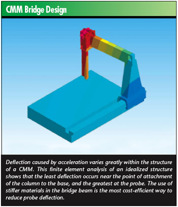

The greater stiffness of ceramic beams shows up in analyses of bridge behavior under acceleration. When accelerated, the bridge beam is subjected to a directional deformation force directly proportional to the acceleration. For an aluminum beam, the resulting directional deformation is nearly twice that of an equivalent ceramic beam, despite the fact that the ceramic component is 32 percent heavier.
In practical terms, this means the ceramic beam can be accelerated nearly twice as fast as the aluminum beam while maintaining deformation within a comparable range. Greater acceleration translates directly into shorter traverse time and reduced cycle time for any given movement and ultimately into a lower total cost for any given inspection task.
