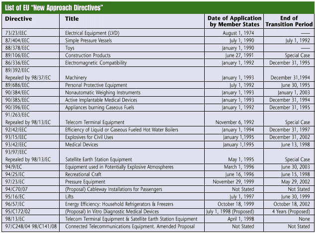

The directives aim to simplify and regulate the movement of goods into and within the EU. In order for the EU to monitor these goods, they require manufacturers to display a CE Marking on applicable products or packaging, and on any accompanying literature. In areas where a directive is in force, it is a crime to place a product on the market without this CE Marking-the manufacturer is legally responsible for ensuring that the product complies with the directive and for placing the CE Marking on the product. The manufacturer also will be held legally responsible for any wrongful placement of the CE Marking on a product. Any directive that applies to the EU and its products is required for any country that sells products there. Thus, as each new directive comes into effect, CE Marking for U.S. goods in that category becomes mandatory. U.S. manufacturers must become aware of the directives and their objectives. The directives are in place to ensure the production of safe devices that are fit for their designated purpose, promote manufacturer responsibility, maintain efficient regulation, benefit the community and control market orientation. Many U.S. manufacturers are finding that they must place the CE Marking on their products to conduct business abroad. The EU is a critical market because it makes up the bulk of the European Economic Area. Established in 1994, the EEA is the largest economic region in the world-consisting of Austria, Belgium, Denmark, Finland, France, Germany, Greece, Iceland, Ireland, Italy, Liechtenstein, Luxembourg, The Netherlands, Norway, Portugal, Spain, Sweden, and the United Kingdom. While not EU members, Iceland, Norway and Liechtenstein are in the European Free Trade Association, which has different rules regarding directives. CE Marking is not a quality standard; it is simply a manufacturer's declaration that a product complies with the essential requirements of the relevant directives. Because CE Marking merely indicates that the product conforms to the minimum legal requirements, it does not ensure that the goods are quality products. It simply allows for the movement of goods and the removal of nonconforming products within the EU. CE Marking is not intended as a marketing tool. In the United States, however, customers often look for the CE Marking on a product to see that it meets these minimum requirements, which other domestic products may lack. The "most popular" directive The Medical Device Directive is currently receiving the most attention. This article therefore uses it as an example to show the steps of CE Marking. The MDD protects patients and operators through the safety, health and quality requirements of medical devices. Its 23 articles explain how it works, with carefully defined steps to guide manufacturers through the conformity procedures. Mandatory in June 1998, the MDD has prompted medical device makers to initiate efforts to affix CE Marking to their products before they lose their eligibility to ship to the EU. The MDD contains four medical device classes-I, IIA, IIB and III. For Class I devices, manufacturers must perform a self-declaration, but no notified body is involved. Class I device manufacturers are on their own, except if the device includes a measurement or sterility function, which requires a notified body to come in to assess the device. For classes IIA, IIB and III, a notified body must be involved. CE Marking basics Obtaining CE Marking can be a long and tedious process, but with the help of a notified body, it need not be overwhelming. Yet sooner or later, companies must undergo the process to continue exporting to the large EU market. For example, the MDD contains five steps: determine classification, meet essential requirements, set up the technical documentation, choose the conformity assessment procedure route and write the declaration of conformity. After completing these steps, manufacturers may affix CE Marking to their medical devices. Before beginning the process, however, manufacturers must first obtain a copy of the directive. (Directives can be found at Web site europa.eu.int/eur-lex/en/search.html . Input the directive number in the search field.) Reading through the document will help them understand what the process entails and what it will mean for selling their product. After examining the 23 articles, the manufacturer should gain a precursory understanding of the process. Beginning the process After understanding the process to follow, the manufacturer begins the classification step. To put the directive into perspective, the MDD is divided into annexes, which are like the chapters of a book and help the manufacturer classify the device. The MDD's 12 annexes are:
