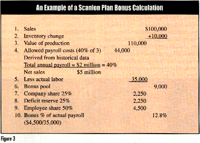

The Scanlon Plan is the oldest and most widely used type of gainsharing plan. It's based on the historical ratio of labor cost to sales value of production. And, because it rewards labor savings, it is most appropriate for companies that have a "high touch labor" content.

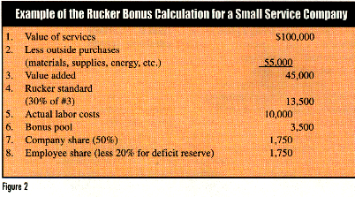

The Rucker Plan is based on the premise that the ratio of labor costs to production value (actual net sales plus or minus inventory changes, minus outside purchased materials and services) is historically stable in the manufacturing industry. This principle became the underlying precept of the Rucker Plan, which tracks the value added to a product as a measure of productivity. Because this plan utilizes a multicost formula, it's most appropriate for organizations that want to improve other variables, such as scrap reduction or energy consumption, in addition to labor.

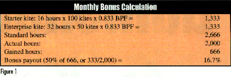

The Improshare formula can best be understood by examining the Dowe Cheatum & Howe company-the world's premiere kite manufacturer. The company was founded by Ben Franklin's brother more than 200 years ago. It employs 100 people-80 employees comprise the direct-labor work force, and 20 comprise management and technical support. DC&H makes two different kites-a starter kite that retails for $500 and the U.S.S. Enterprise kite that sells for $2,500.
DC&H bases their formula on engineering work standards, which are calculated by dividing the total production work hours by the number of units produced. For the starter kite, the work standard is 40 direct labor employees x 40 hours/50 kites, or 32 hours per kite.
The total standard value hours in the base period is 4,800. Improshare plans use a based productivity factor to factor in all production and nonproduction hours within the base period. Once these hours are added together, they are divided by the total standard hours (4,800), or 0.833. The bonus calculation for the month is shown in Figure 1.
