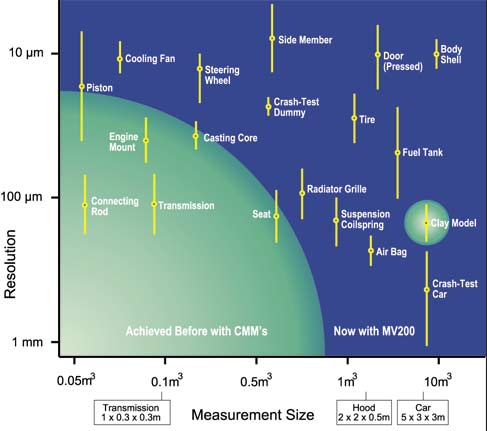

 The aerospace and automotive industries have typically taken the lead in finding innovative solutions to measurement problems. Figure 1 highlights some of the automotive components whose production utilizes noncontact applications. Auto industry leaders have incorporated FMCLR noncontact measurement technology into their design centers for model digitization and reverse engineering. Aerospace firms such as Boeing are also early adopters of the coherent laser radar system, and even antenna manufacturers have improved the performance of their antennas by identifying, modifying and rechecking subtle surface irregularities.
Figure 1: Noncontact Sphere of Opportunity (Automotive)
 Noncontact measurement speeds manufacturing, improves quality and lowers manufacturing costs. An FMCLR instrument can be used to accurately align large parts during assembly. It can certify tooling and then monitor repeatability during production. It can be used to scan objects that were previously impossible to scan due to their size, inaccessability, very complex geometry or delicate surfaces. It operates at the object's location without a conditioned environment and without the need for expensive tooling. Offset calculations aren't required because measurements are taken directly from the part surface. The system, whether used indoors or outside, can operate in any lighting and on any surface with a reflectivity of 1 percent or more.
 FMCLR can be used for many applications. It can rapidly sample metal, plastic and composite as-built surfaces and compare them directly to a CAD model. It can gather data over extremely large areas in a contiguous coordinate system and, because operators can accurately measure from key features or reference points as they go, relocating the system eliminates the need for complicated reassembly of data clouds. For those who want to digitize models or hand lay-ups, data can be gathered in uniform scans with control of point density and area and then be exported directly to a wide variety of CAD packages.
 Tool builders can locate and adjust tool positions and features in real time, driving the system to a specific point in space and measuring a part continuously until it is positioned at its nominal location. Operators can also measure tools and surfaces for wear, monitoring surfaces for tolerance and stability and documenting tools and die surfaces. For in-process applications, the system can support robotic positioning and then monitor conditions like orientation, gap, flushness and fit. In addition, it can be used to monitor tool and fixture stability during use without the need to manually collect datum information. A single machine can monitor several manufacturing work cells automatically without the need for operator intervention.
 For quality professionals, an FMCLR can perform first-article inspections and be used for incoming, in-process and outgoing quality assurance. Because the instrument can scan a part surface directly, it's well-suited for measuring tight pockets, small holes and otherwise inaccessible areas. For routine maintenance, the system can perform static and dynamic inspections of aircraft, automotive and heavy equipment tooling assemblies. It can monitor deformation of building, tunnel and bridge structures and accurately measure surface fractures that can provide early warning to possible fatigue and structural failure--an especially useful capability after seismic activity.
