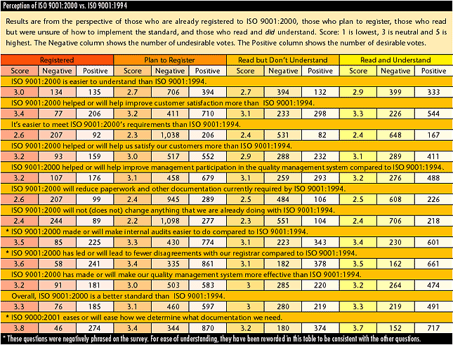

We asked a number of questions related to the new standard's usability, understandability and usefulness. The results in the table on page 24 are presented in two ways. The first is a numeric score based on the 1 to 5 scale used for responses: 1 is the lowest, most negative perception, 5 is the highest, most positive perception and 3 is neutral. The other format shows the actual number of positive, above neutral answers and the number of negative, below neutral answers.
The scores are generally low, indicating mostly negative perceptions of the standard. One of the lowest-scored statements, even among those who had completed the transition, was "It's easier to meet ISO 9001:2000's requirements than ISO 9001:1994."
"The old standard was very light on talking about an integrated system, offers West. "Individual processes were treated in isolation. Under the new ISO 9001 you need to look at the overall processes. And that, for some companies, is a major change, almost profound."
The statistics requirements could be another issue, says Mark Lutz, an ISO 9000 consultant. "The main problem area I've seen with my clients has been coming up with measurable objectives and following through on measuring and analyzing to those objectives," he explains. "Section 8 of the new standard talks about measuring processes using statistical analyses. The old standard was much lighter--only requiring statistical analyses where the company identified the need. The new standard is much more prescriptive in this area, saying you need to measure, analyze and improve processes. . . and here's where you need to do it."
On the positive side, most felt that auditing was easier and less prone to disagreement with the registrar compared to the old standard. From those who have already transitioned, both registrars and internal auditors got high scores for understanding how to audit to the new standard.
In general, the response to the standard was mediocre. Much of this could be attributable to a reluctance to change or, as several registrars pointed out, discomfort with a completely different way of viewing a quality management system. It will take a couple of years to assess the real benefits of the new standard. In the meantime, West likens it to an old Philip Crosby lesson: "The first of Crosby's lessons was to do it over again," recalls West. "The system becomes stale unless you refocus it. That's one of the objections to formal systems; they become a bureaucracy. I encourage people to look at this change as an opportunity to make their system better. This is a great opportunity. Take it."
