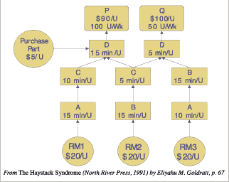

 Every organization has constraints, which come in many forms. When a production or service process has a resource constraint, the sequence of improvement projects should be identified using very specific rules. According to Eliyahu M. Goldratt, the rules are:
Figure 1: A Simple Process with a Constraint
1. Identify the system's constraint(s). See if you can identify the system constraint in Figure 1. The answer is printed at the end of this column. This fictitious company produces only two products, P and Q. The market demand for P is 100 units per week, and P sells for $90 per unit. The market demand for Q is 50 units per week, and Q sells for $100 per unit. Assume that A, B, C and D are workers who have different, noninterchangeable skills and that each worker is available for only 2,400 minutes per week (8 hours per day, 5 days per week). For simplicity, assume there's no variation, waste or similar problems in the process.

Table 1: Process Scrap rates
 The TOC approach is superior to traditional total quality management project selection. For example, consider the data in Table 1. If you apply Pareto analysis to scrap rates, you would begin with Six Sigma projects that reduced the scrap produced by Worker A. In fact, assuming the optimum product mix, Worker A has about 25-percent slack time, so the scrap loss can be made up without shutting down Worker B, who is the constraint. The TOC would suggest that the scrap loss of Worker B and the downstream processes C and D be addressed first, the exact opposite of what Pareto analysis recommends.
