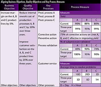

 To do this, it's necessary to understand which processes are key to achieving business goals and align those processes with the quality objectives. This step isn't specifically mentioned in ISO 9001:2000, but it's implied in clause 7.1, which states that appropriate measures should be developed for process goals. A simple example is given in the table on page 41.
 If, for instance, a key business objective is to increase the margins on certain products, several courses of action are available. An organization might decide to reduce costs while improving customer satisfaction. This would enable it to retain the cost savings as profit. Alternatively, with improved satisfaction, customers might be willing to pay for the additional margin. The example on page 41 shows how the cost-reduction goal (i.e., the business goal) can be aligned with quality and process objectives (i.e., improving customer satisfaction). A similar alignment could be developed for improving customer satisfaction once the key factors influencing satisfaction are determined.

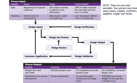

 Process mapping involves more than just flow charting. Among other things, it can manage and improve processes by illustrating process measures as well as process flows and interactions. One process-mapping method begins by involving the people who work in the process. Another entails mapping the process as is, taking action to improve it and then preparing a final map of the improved process.
Determining the process outputs should be the first step in this second method. For this, a team should consult with process customers, both internally and externally. What do they need, expect and want from the process? How can these requirements be measured, and what are the current results?
 The same activity should be conducted for process inputs, this time consulting with process suppliers. After the inputs and outputs have been defined, a flow chart can be prepared using normal flow-charting techniques. Make sure the flow chart shows the process as it is, not as it should be. Once the flow chart has been created, it might be necessary to measure some of the individual activities within the process to provide a full picture of performance.

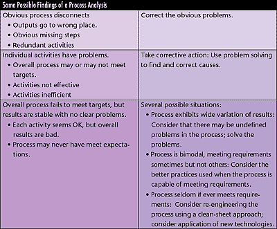

 Analyzing a process can provide insight for improvement. The table on page 42 summarizes some of the possible opportunities that may be discovered.

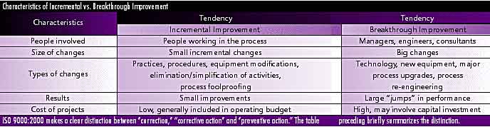

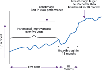

 Real improvement isn't accidental. It requires effort and generally takes place on a project-by-project basis. Recognize that there are two types of improvement: incremental and breakthrough. They have different characteristics, some of which are described in the table below. ISO 9004:2000's clause 8.5.4 and Annex B discuss these concepts in more detail.

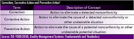

 At this point, it's helpful to clarify the difference between corrective and preventive actions, two standard tools used in the continual improvement process. Corrective action addresses an undesirable situation's cause in order to prevent its recurrence. Preventive action, by contrast, addresses the probable cause of a potentially undesirable situation.
It's also important to rethink the way we view corrective and preventive action. Because corrective action involves determining and correcting causes of undesirable situations, it should be considered part of the organization's overall problem-solving process. As an added benefit, integrating a corrective action process and other problem-solving activities simplifies training and focuses everyday activities on important issues such as optimizing resources. Each corrective-action activity should be recognized as a project for improvement, and the resources devoted to each project should be commensurate with the problem's importance.
