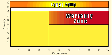

Those who use FMEAs need to learn that the class value is more important than the RPN. The class value, derived from the severity/occurrence matrix shown in Figure 2 below, puts the RPN into its proper perspective. The class matrix shows that any FMEA line with a severity rating of nine or 10 lies within the Legal Zone and poses a possible legal risk. These must be addressed regardless of the occurrence rating. The Warranty Zone shows combinations of severity and occurrence ratings that could lead to field failure with a probability that is unacceptable to the company (typically > 1/15,000). These items also need to be addressed.
In the example in Figure 1, the RPN of 40 seems to indicate no need for action. However, the class matrix indicates that line one falls into the Warranty Zone, indicating a problem that will lead to dissatisfied customers and cost the company money.
Line two in Figure 1 shows an RPN of 80 that would raise flags for an auditor but doesn't fall into either the Legal Zone or Warranty Zone. Therefore, careful consideration must be given as to whether to spend time and money correcting this problem.
Unfortunately, auditors and those who use FMEAs often look only at the RPN and ignore the class, which leads to wasted effort on problems of little significance.
Figure 2: Class matrixFmea
