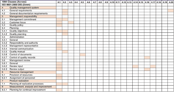

 For a quick comparison of where management responsibility elements from the 1994 version are found in the ISO 9001:2000 DIS, refer to Figure 1.

Figure 1: ISO 9001:1994 Management Responsibility Clauses Cross-Referenced to the ISO 9001:2000 DIS
