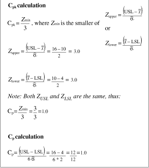

Example 1
 Examples may yield a better understanding of capability and of the relationship between Cp and Cpk in particular. In Example 1, the process is in control and the parts being produced reflect a normal distribution. The upper specification limit (USL) is 16, and the lower specification limit (LSL) is 4 .
 Since the process is centered, Cpk and Cp are equal.

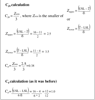

 Now assume that we still have a stable (in-control) process and that the parts we're producing follow a normal distribution. The parameters for Example 2 are the same except for X, which is 11 instead of 10.
 In Example 2, the process is not centered in the specifications. Because of this, the Cpk is smaller (0.83), but the Cp has stayed the same (1.0). This is why some would say that a Cp is what the process could do if it were centered. A Cpk describes what the process is doing and reflects how far off center the process is.
Example 2
