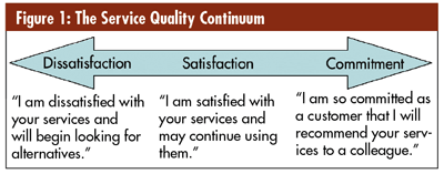

Customer perceptions are key
Customer perceptions are critical in any product context. In the world of service delivery, they’re especially important due to the personal and interactive nature of services. You may satisfy every stated requirement and still fail to satisfy the customer in a profound way. The ground is shifting as the service is performed, and what you think was perfect may be far from satisfactory. That’s why you must specifically ask your customer what he or she thinks about your services. Don’t provide a long survey that probes every aspect of the service experience; just start with two simple questions: “How satisfied are you with the quality of our services?” and “How likely are you to recommend our services to a colleague?”
These two questions apply to nearly any service situation and industry. The first question addresses basic satisfaction, essentially asking if the services met all requirements. The second question takes this a step further and addresses true commitment: Do you feel strongly enough to recommend our services to somebody else? These represent two different places on the same continuum (as seen in figure 1), and both arenecessary for long-term success.
It’s worth noting that satisfaction falls only in the middle range of the continuum. The blunt reality of business is that basic customer satisfaction is no longer adequate for businesses to remain successful. Basic satisfaction simply means that they might use your services in the future--unless a better offer comes up. Satisfaction is little more than the absence of dissatisfaction, and there’s no glory in just squeaking by. Satisfaction is a reasonable starting point, but the ultimate goal is the kind of commitment that results in customers telling their friends and colleagues about your organization and recommending your services. That’s what you should be striving for.
