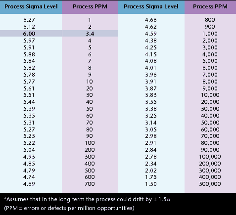

 The table of process sigma values and equivalent parts per million shows the equivalent yields that you obtain when the 1.5 sigma shift is taken into account.
 Use the table as follows:
  When data are from measurements, calculate the average and standard deviation. Then determine how many standard deviations there are between the mean and each specification. Find the PPM level in the table corresponding to this number. Add the PPM values for the lower and upper specification and look up the process sigma level in the table.
 Example: Hole diameter specification = 0.990 in. to 1.010 in. Average = 1.005 in., sigma = 0.0025 in. standard deviations to upper specification: 2 (by interpolation, PPM = 307,400)1 ; standard deviations to lower specification: 6 (PPM = 3.4 or approximately 0). Therefore, expected errors = 307,400+ or a process sigma level of 2.
  If data are from observed counts of errors or defects, convert the count to PPM using the formula PPM = 1,000,000 x (error count/error opportunities). Look up the PPM value to find the corresponding process sigma level.
 Example: 400 units were shipped, and 10 were returned as defective. PPM = 1,000,000 x (10/400) = 25,000, or by interpolation, a process sigma level of 3.47 2.
Process Sigma Levels and Equivalent PPM Quality Levels*
 In the counts example above, we computed a process sigma level of 3.47 based on observing a 2.5 percent defective rate. If you look up Z = 3.47 in a normal table, you find that the predicted defective rate is 0.03 percent, which is much better than the observed result. Many statisticians look at this as taking undeserved "credit" for 1.5 sigma. This view reflects an overly narrow statistical interpretation of the 1.5 sigma shift. If we look at the shift as an attempt to make our model correspond more closely to reality, the interpretation is as follows: The customer observed 2.5 percent failures during actual use of our product, which corresponds to an estimated internal failure rate of only 0.03 percent.
