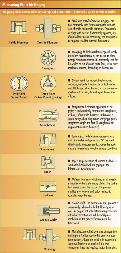

In the competitive world of manufacturing, many companies are looking to increase quality and productivity while reducing frivolous expenses. Some have set their sights on noncontact measurement as a means of saving valuable resources. One such type of measurement is air gaging, a method of precise comparative dimensional measurement that offers users the advantages of improved workflow, increased productivity and decreased downtime.
As this article explains, air gaging is ideal for measuring dimensions with tolerances smaller than 0.005 in. When gaging tight tolerances, resolutions as small as 0.000002 in. can be achieved. Its noncontact characteristic makes air gaging particularly useful for checking soft, highly polished, thin-walled or other delicate materials.
Air gaging’s benefits
Chief among the benefits of air gaging is its ease-of-use, which helps produce accurate results even when performed by unskilled employees. Operation is as simple as presenting a tool to a workpiece and observing the reading. Speed is another benefit: A row of multiple-column amplifiers can be scanned in one glance, reducing time and fatigue. Moreover, relationships (e.g., squareness) that cannot be checked by fixed-limit gaging--and are costly to do by other means--are easily measured with air gaging.
Air gaging is also economical. Once the basic system is purchased, relatively inexpensive additional tooling can be used for a wide variety of applications. Air gages effectively measure all common types of dimensions and are particularly suited for measuring dimensional relationships and match gaging.
Most air gaging systems operate at air pressures that can purge workpieces of contaminants (e.g., abrasive particles, coolant, etc.) at the measurement point, eliminating the need for separate cleaning in most operations. And, because air gage tooling has no moving parts, it’s virtually immune to fouling. Air gaging offers a wide choice of tooling for single or multiple measurement applications, and when repair is needed, air tools are simple to fix.
A brief examination of the fundamentals of air gaging will illustrate the basic premise of air gaging and its evolution into today’s manufacturing environment.
How does it work?
To achieve its precise dimensional measurement, air gaging relies on a law of physics that states flow and pressure are directly proportionate to clearance and react inversely to each other.
The regulated air flows through the restriction (e.g., a needle valve or jeweled orifice) and then through the nozzle. When the nozzle is open to the atmosphere, there is maximum flow through it with minimal pressure--called “back pressure”--between the restriction and the nozzle.
As an obstruction is brought closer to the front of the nozzle, air flow from the nozzle diminishes, and back-pressure builds. When the nozzle is completely obstructed, air flow is zero and back-pressure reaches the pressure of the regulated air supply. During this example, air flow moves from maximum to minimum, whereas back-pressure moves in the opposite direction: minimum to maximum.
These values can each be plotted against the nozzle’s clearance from the obstruction. Except for the extremes of both back-pressure and flow, the curves are straight lines, representing the linear proportions that establish the basis for all air gaging.
Thus, measured decreases in flow provide an accurate correlation between the distance of the nozzles in the air gage tool and the obstruction (i.e., the surface of the workpiece being measured). Similarly, increases in back-pressure indicate less distance between the tooling nozzles and the workpiece.
