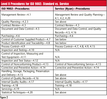

Our own management system became easier to define as we reviewed ISO 9004-2, keeping in mind the elements shown in Figure 1. ISO 9004-2 helps define key components of a service organization and gives direction to the organization for applying the manufacturing-based requirements listed in the ISO 9002 standard. Figure 1 represents the key pieces of a service organization’s management system: management, customers, policy and procedures, and resources. It’s important when businesses begin to define their intent with ISO 9000 to tie the requirements back to these key elements.
Ryan Transportation is well-suited for a true service-based management system. It’s looking to enhance its business processes and meet future customer needs. When Ryan and Eagle Group teamed to implement an ISO 9002-registered management system, our goals were to develop a system based around Ryan’s current practices rather than the ISO 9002 standard; keep the system lean, effective and value-added; and keep the company’s processes responsive from a sales perspective.
Eagle Group’s approach to implementing a service-based ISO 9000 system emphasizes flexibility and responsiveness. Service organizations, just like manufacturing companies, function best when they can offer quick response times to customer needs and order changes. However, the service provided often is the only “product” it has to measure. Consequently, its management process must be a constantly evolving system based on whatever customers want, when they need it.
Our first step with Ryan was to perform a gap analysis comparing the systems currently in place against what the ISO 9002 standard requires. Then we mapped the standard elements to those systems and processes. By doing so, we laid the groundwork for determining what elements were applicable and how we could structure the content and quantity of procedures based upon existing business processes. This method differs from more typical procedures that structure business processes around ISO 9001’s 20 elements or ISO 9002’s 19 elements, as shown in Figure 2.
Many elements that apply to manufacturing organizations are easily left as procedures relative to a specific department. This isn’t the case within a service industry. For example, when we think of process control procedures, we typically envision manufacturing lines with operators and equipment. For Ryan Transportation, process control actually means its interaction with customer-supplied product, product identification and traceability, and handling, storage, packaging, preservation and delivery.
For a service provider, implementing a quality management system requires    understanding nonmanufacturing environments in order to develop procedures that maintain ISO 9002’s intent without overcomplicating the documentation.
Ryan Transportation also is typical of many organizations in that resources and time are valuable commodities. The system must be lean, functional and easy to maintain. Based on these factors, we developed a seven-page policy manual, less than 10 standard operating procedures tied to the business’s various functional areas and a handful of key work instructions (as outlined in Figure 1). Standard operating procedures and work instructions are kept short and concise to ensure they are understood and used by all staff members. The streamlined process developed for changes, revisions and corrections works in conjunction with the company’s continuous improvement process.
While developing procedures and supporting documents, we focused on improving process, communication and record keeping. This ensured that Ryan’s system would help the company manage its growing business and keep it flexible in meeting customer needs as well as daily and hourly market changes. During this process, the management team interacted with staff members to mark the starting point for future process improvements. “This process means a lot of time and effort for a company our size, but it’s going to help us define processes for our existing people as well as new people,” noted one of the management team members.
Certain concerns arise when implementing ISO 9002 in a service organization, and Ryan experienced its share of them. Service providers always struggle with implementing elements 4.3 -- Contract Review and 4.6 -- Purchasing. Most service organizations’ operations don’t depend on lengthy contracts, with review and approval processes between provider and the customer.
Similarly, most service organizations don’t have a formal process for subcontractor evaluation or purchasing. When they’re not based on the practical business system of a service-based organization, these issues can become a burden. A system must allow for quick order turnarounds of one to four hours from start to finish as well as spontaneous purchasing within that time frame.

Certainly many of the elements -- such as management review, document and data control, corrective and preventive action, control of quality records, internal quality audits and training -- are relatively straightforward. However, mapping ISO 9002 or ISO 9001 into a service organization’s relevant areas often proves more of a stretch. An important reference for any service company prior to program implementation is the ISO 9004-2 service guidelines.
As a registrar, we must first verify that the service has been defined realistically. The next issue is applicability. For example, ISO 9002’s element 4.11 -- Control of Inspection, Measuring and Test Equipment almost certainly won’t be defined in terms a production environment would use. Key factors in interpreting and adapting the requirements would certainly include service specification, service delivery process and customer assessment.
