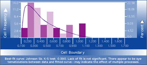

                                                     If you study the graph further, there appear to be two groups of data points. One group is centered around a pressure of 0.00004 to 0.00005. The other group extends
                                                    beyond a pressure of 0.00007 and up to an adhesion value of 1.0. If there are indeed two groups in this data set, that should show up on a histogram (Figure 2).  Figure 2: Histogram of Adhesion Data
                                                      This analysis might not stand up to a rigorous statistical examination, but I think I can
                                                    see a bimodal distribution here. The data to the left of 0.4 seems different than the rest. If that's the case, there could be two or more special causes of variation affecting this
                                                    process. We'll continue to investigate our process, but we'll move beyond standard analytical methods.
