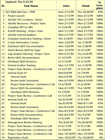

 Table 1: ISO 9002 Roll-Out Schedule
After the conclusion of the gap analysis, modifications to the QMS documentation were made. Controlled manuals were distributed to the entire project team and the individual branch manager or branch operations manager set out to train their employees on the QMS. The training was conducted element-by-element on a schedule to least interfere with normal business operation.
 During the training period, ART selected a group of employees to attend a two-day internal auditor training program conducted at ART's headquarters. ART selected employees from different levels of the company for auditor training to disseminate knowledge about the new QMS corporationwide.
 Shortly after the auditor training, internal audits were scheduled at all of the locations (headquarters, pilot site and the additional sites). This provided hands-on training for the auditors and gave the company different perspectives on its QMS documentation and processes. The regional operations managers, who usually functioned only within their geographic regions, traveled to sites outside of their regions and witnessed how other stores were accepting these processes. The audit paperwork was submitted back to headquarters, where the management representative and deputy management representative reviewed and quantified the nonconformances by location and element (see Table 2). By quantifying the nonconformances in this manner, they were able to see not only which locations required more training, but also the elements in which they were receiving nonconformances. The nonconformances were reported to the members of the management team so that they could identify potential problems and direct the appropriate resources to that location. Once again, after each audit, a telephone conference was held with the entire project team to discuss the outcome of the audit, address problem areas, determine corrective actions and revise the documentation.
 A second round of audits followed a month and a half later to ensure that appropriate corrective and preventive actions were installed, supplemental training was conducted, the system was still functioning as planned, and all employees within the system were participating. Again the internal audit paper-work was forwarded to the management representative and deputy management representative to ensure that satisfactory audits were performed and to analyze the nonconformances by element and location. Another telephone conference with the entire project team was held to discuss the second round of audits and the final stages of implementation of the QMS prior to the certification audit. Management anticipates that they will pass their certification audit and that the additional stores will be added to their certificate by November 1999.
