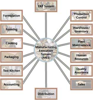

asked Interwave to help design the new facility systems to provide the greatest flexibility and throughput while maintaining strict cost control and adherence to regulatory and quality requirements. Project scope The MES was deployed in a layered architecture between the newly developed business ERP system
and the existing shop floor equipment, instrumentation and controls. As the centralized data warehouse for the entire production facility, the MES provided automatic interface to and synchronization and control of all
of the functions or systems depicted in Figure 1. The MES architecture
includes an NT applications software server, 15 NT client workstations, auto-ID equipment, process control and instrumentation interfaces, and an interface for the existing ERP system (hosted on a UNIX
