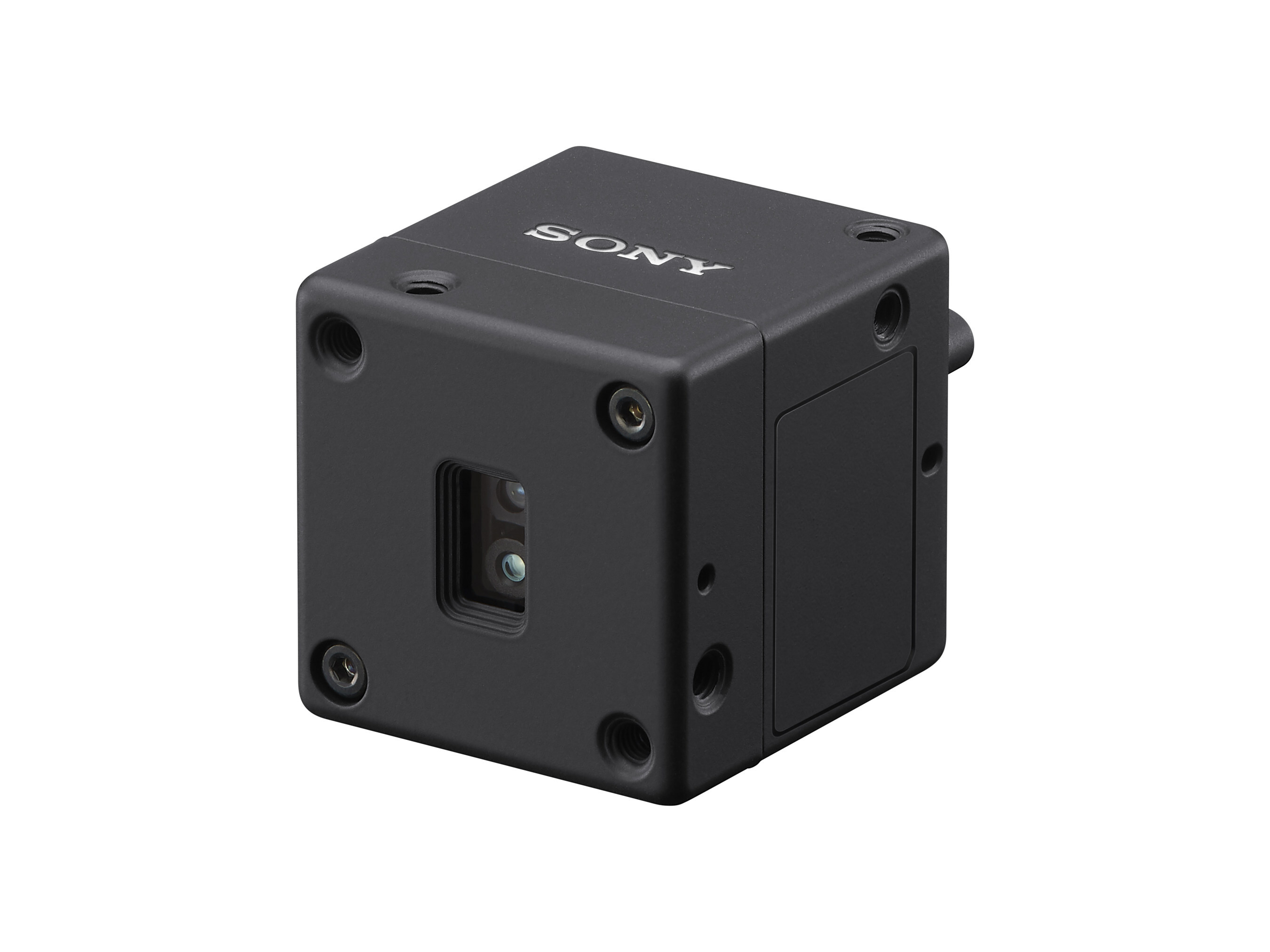

(Sony Electronics: San Diego) -- Sony Electronics Inc. has announced commercialization of its AS-DT1 LiDAR depth sensor. The AS-DT1 is the world’s smallest and lightest LiDAR depth sensor structure, measuring just 29 mm x 29 mm x 31 mm (approximately 1.14 in. width x 1.14 in. height x 1.22 in. depth), excluding protrusions, and weighing only 50 g (approximately 1.76 oz). It leverages miniaturization and optical lens technologies from Sony’s machine vision industrial cameras, making it ideal for applications where space and weight constraints are paramount, including drones, robotics, and more.
AS-DT1’s “direct time of flight” (dToF) LiDAR technology delivers fast and accurate measurement, distance resolution, and measuring range. The proprietary dToF ranging module, equipped with a single photon avalanche diode (SPAD) sensor, utilizes multiple ranging points for distance measurement and can accurately measure distances in three dimensions: length, width, and depth.
The AS-DT1 can measure distances to low-contrast subjects and objects with low reflectivity that are more difficult to detect with other ranging methods. This enables accurate measurement of distances in diverse environments, such as retail stores, where various objects, including people and fixtures, are present. In addition to its ability to accurately measure distances both indoors and outdoors, the sensor’s compact, lightweight design and rigid aluminum housing allow for integration into a wide range of devices, such as food service robots in restaurants, autonomous mobile robots in warehouses, and drones used for inspections and surveys.
