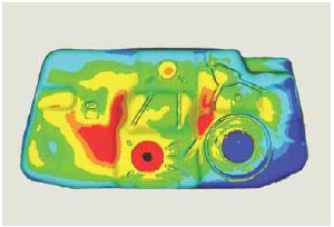

Color-coded reports illustrate geometry deviation and highlight where geometry tends to go are out of range.

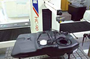

Laser scanning also reduces or eliminates the effort that is required to align fuel tanks on the CMM. As fuel tanks have sufficient weight and rigidity, there is no need to invest in complex clamping and fixation tools. Boltz explains that a fuel tank is presented for inspection by positioning it on vertical stands that support the tank in free-state condition.

Boltz explains that the inspection process at Kautex is embedded into the digital CAD-centric manufacturing process. An advantage of digitizing fuel tanks up front is the flexibility to run analysis at any later time. After aligning the acquired point cloud with the nominal shape, Focus highlights geometry deviation between fuel tank and CAD or between two tanks. Automatic geometry comparison is performed either using global best fit or alignment on the basis of datum reference points. “At a single glance, we see where geometry tends to go out of range. We apply different fitting methods to easily distinguish between inaccurate fuel tank geometry and incorrect datum point levels. Quickly gaining relevant insight is critical for us in efficiently tuning the mechanical blow molding fixtures used in production. We share graphic reports with colleagues and customers, who interactively analyze them using the license-free Focus Viewer,” continues Boltz.
Kautex runs laser scanning to effciently capture the freeform surfaces and geometric features of fuel tanks
