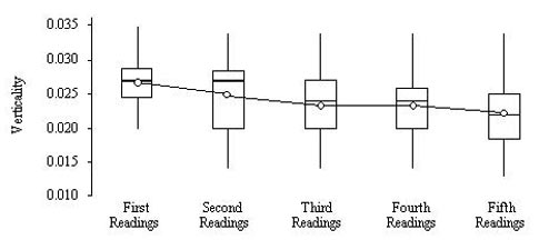

Another supplier measured the verticality of a shaft. Their sampling plan called for a subgroup size of five. (No real reasons other than there were five spaces for readings in the template.) While the supplier did manually plot the data in a control chart, they did not spot the pattern shown by the box plots in figure 6. There we see that successive readings in each subgroup are lower than the preceding readings. Something is happening, but they didn’t know to look for this until the data were plotted as shown in figure 6. Plot the data. Take action.
Figure 6: Box plots of Verticality vs. Position in Subgroups
Starting from the top down, I look for differences between suppliers, plants, shifts, lines, machines, spindles, operators, etc. The key to creating useful graphs that reveal the structures within the data is to use the context for the data as a guide. Think about the kinds of differences that could occur, and then draw a graph that will let you see if those differences are present in the data. It is this act of thinking about the data within their context that leads to useful graphs and the ability to take action.

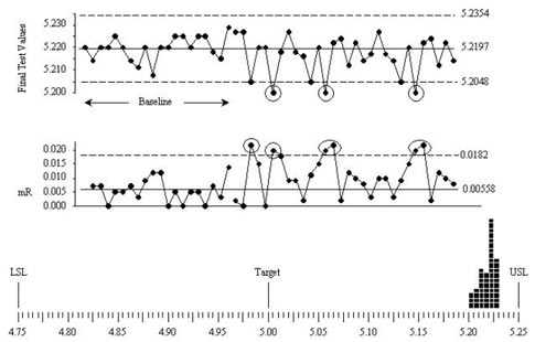

Another supplier calculated a Cp of 16.8 and a Cpk of 2.0 for a final test voltage. Because both were above 1.33 no action was taken. However, as noted earlier, this discrepancy between the capability ratios represents an opportunity for centering the process at the target value of 5V. The XmR chart for 50 final test values in figure 8 shows a process that is subject to upsets. The histogram shows how the process is off target.
One popular piece of software tested these data for normality. Such a test is complete nonsense. According to Walter A. Shewhart, we are not concerned with whether the histogram might or might not be normal, but merely with the assumption that the data might be homogeneous enough to be characterized by a single probability model. Whenever the process is operated unpredictably, there is not one probability model, but many. Hence, testing the data for normality prior to having a predictable process is merely a triumph of computation over common sense.
Here there is a real need to determine what is causing the process upsets. Otherwise, in spite of having a Cp value of 16.8, the next upset might take this process outside the specifications. In the meantime, centering this process would buy some insurance that the product will continue to meet specifications in spite of the process upsets. Plot the data. Take appropriate action.
Figure 8: XmR Chart and Histogram for Final Test Values

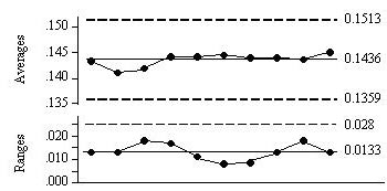

Another supplier collected data every two hours to manage surface run out. They stored the data in a file cabinet—one sheet of paper for each day. Until the data were plotted, they had no idea that the process was getting worse month by month by month, as may be seen in figure 9. A little bit here, a little bit there, a gradual drift toward destroying their reputation. Plot the data. Take action.
Figure 9: Average and Range Charts for Surface Run Out

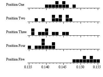

Another supplier sampled solder paste thicknesses at five locations on a printed circuit board (PCB). They used the five values from a single PCB as a subgroup and created an average and range chart. This time they plotted the data but didn’t take the correct action, because they failed to correctly diagnose the average and range chart shown in figure 10.
Figure 10: Average and Range Charts for Solder Paste Thickness
When they averaged the solder paste thickness for the five sites on the PCB they masked the individual site thicknesses. The average and range chart shows the data hugging the central line, which is an indication of possible stratification. Stratification occurs when each subgroup combines values that are systematically different, and the high values average out with the low values, making both the ranges and averages “hug” their central lines. While figure 10 looks like the process is in control, it is not a true representation of the process.
If we look at the five individual sites on the PCBs in figure 11 we see that position five has consistently higher thickness values than the other four locations. With this understanding of the solder paste thicknesses you can adjust specific nozzles and pressures to eliminate these differences. The problem with the average and range chart in figure 10 is inappropriate subgrouping. Whenever you subgroup two values together you are making a judgment that those two values were collected under essentially the same conditions. When unlike things are subgrouped together the average and range chart will fail to deliver the message contained within the data. Plot the data properly. Take action.
Figure 11: Histograms for Solder Paste Thickness for Each of the Five Positions

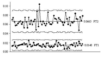

Example 11
I asked another supplier about their final functional test performance. They had two test stations (FT1 and FT2), which prompted an automatic question, “How different are these two machines?” A just about automatic answer was, “They’re both the same manufacturer and model; no difference.”
Figure 12:  P-Charts for Proportion Rejected by FT1 and FT2 During the Same 60-Day Period
I asked how they knew they were both the same and could they show me the data. While finding the person who knew how to get the data, we looked at the logs for both machines, which indicated that one had a reject rate of about 1.5 percent while the other had a reject rate of about 6.5 percent. They got me the number of rejects per day for about 60 days. Looking at the data over time in a p-chart you can see that the two machines are doing completely different jobs. I asked if they purposely routed the difficult or borderline cases to FT2 and they said no. So now they need to determine if there is a systematic difference in the two production lines or if this difference is merely a difference in the two testing machines. Plot the data. Take action.
