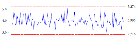

Three years ago this month Quality Digest Daily published my column, “Do You Have Leptokurtophobia?” Based on the reaction to that column, it contained a message that was needed. In this column I would like to explain the symptoms of leptokurtophobia and the cure for this pandemic affliction.
Leptokurtosis is a Greek word that literally means “thin mound.” It was used to describe those probability models that have a central mound that is narrower than that of a normal distribution. In reality, due to the mathematics involved, a leptokurtic probability model is one that has heavier tails than the normal distribution. By a wide margin, most leptokurtic distributions are also skewed, and most skewed distributions will be leptokurtic.

Transformations are often appropriate
If I am dealing with a process that is in control, but whose data is nonnormal, my inclination is always to fit the underlying distribution and then set appropriate control limits. Then accurate process performance indices can be computed; StatGraphics and Minitab can in fact do this for nonnormal distributions. AIAG's SPC manual sanctions this approach for nonnormal systems.
Figures 1 and 2 represent two "processes" and therefore a bimodal distribution, for which no SPC scheme is appropriate. Figure 3 looks like it has numerous outliers in its upper tail, and therefore represents a system with assignable causes. If so, even if the underlying distribution were normal, it would not be possible to do SPC based on this process history. This underscores the fact that, as you said, the first step is to check for nonhomogeneity.
It might be interesting to model the situation in Figure 3 with a beta distribution (model for activity completion times in project management) as well as a lognormal distribution, but without the numerous outliers--if they can all be identified.
Submitted by Donald J. Wheeler on Fri, 08/03/2012 - 05:54
In reply to Transformations are often appropriate by William Levinson
Levinson on Transformations
William, I do not know who taught you SPC, but you should ask for your money back since they did a particularly bad job. Virtually everything you say contains some sort of error. A process behavior chart is the universal technique for examining a data set for homogeneity. It does not impose any requirements upon the data. We do not have to fit a model to our data before we "do SPC." We do not need to verify the normality of the data prior to using a process behavior chart. We do not need to remove the outliers prior to placing the data on a chart. And as for fitting a lognormal, the uncertainty in the statistics means that you can fit a very wide spectrum of lognormals to these data, making a unique distribution impossible to justify.
Submitted by bdaniels on Tue, 08/07/2012 - 14:02
Levinson on transformations
I think the point is not that transformation is wrong per se, but that transformations are not necessary or even useful for industrial improvement studies.  Can data transformations help us understand something about the data before us?  Yes.  But what do they help us understand?  That is the real point of this discussion.  In Statistician lingo it’s about setting the correct frame.  A transformation of Non-Normal data can help us to calculate a Cpk/Ppk index.  But the real question is how useful is the index itself?  what can it tell us about the process that a simple time series plot can’t?  (answer:  nothing really, it just gives a precise number that quantifies one aspect of the process)  Process Capability indices yield no informative understanding to drive improvements.)
Transformations help us get mathematically precise answers to math questions when the data before us are Non Normal and/or non-homogenous; they do not help us get actionable answers to physics questions.  The industrial world is trying to solve physics problems not math problems.  It comes down to two things:
­       - Real processes can be stable and capable even though they are non-homogenous and not Normally distributed.
­       - Solving real industrial problems requires analytic studies not enumerative studies.
Real world processes are often not well behaved like the processes used to teach mathematical statistics. A homogenous Normal distribution may be the “ideal” but it is not required to make quality product in a reliable and profitable manner.  Unfortunately it is required for many (distributional) statistical tests of significance.  Therefore we are taught that any distribution that is not Normal ‘must’ be transformed to use these common statistical tests.  This approach has transformed over the years into an incorrect belief that any process that is not homogenous and Normally distributed must be ‘bad’.
Fortunately, analytic studies rely on replication and probability instead of distributional statistics.
So the question isn’t whether or not one can transform the data or if there are situations where transforming the data might be helpful.  They are helpful in ENUMERATIVE studies and in limited ways in some complex modeling to assist in calculations.  The point of the article is to say that transformations are not helpful and often misleading in ANALYTIC studies.  Not transforming the data helps us see what is really going on.  I've solved hundreds of complex real world problems and never performed a transformation - they are not necessarry.
A time series or other multi-variate plot is almost always the most valuable analysis tool the analytic study has…if you plot the hurricane data in time series you can clearly see the patterns – there are no ‘outliers’. There is the non homogenous effect of factors that cause hurricanes changing…transforming this data hides the causal system and suppresses knowledge.  This data can be found at:  http://www.aoml.noaa.gov/hrd/tcfaq/E11.html
