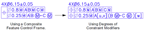

The 2009 Standard finally generalizes the Composite Feature Control Frame tool to permit up to a total of four tiers, and, although well hidden, actually states the Rule of Composite Feature Control Frames (§7.5.1.8 p135) namely: “The datum features referenced in the second and all lower tiers of a composite feature control frame may only constrain rotational degrees of freedom”.
However, if the Datum Features in the second and all lower tiers may only constrain rotational degrees of freedom, the 2009 Standard (see Fig. 7-42 p.138) has failed to correct an error in the 1994 Standard (see Fig.. 5-25 p.122) where datum features B and C are left in individual compartments in the second tier, but must in fact be referenced as composite, namely [B-C], in order to perform their function. This is true, because B, as a stand-alone Datum Feature, can only constrain the first two degrees of rotational freedom which A has already constrained, and therefore serves no purpose. C on the other hand, as a stand-alone, can, may and must constrain roll, but must do so on its own, instead of working in conjunction with B as it does in the first tier and must therefore continue to do. The following alternative Feature Control Frames properly encode the functional requirement:
Finally, the new Standard fails to demonstrate that the Composite Feature Control frame can be replaced using the newly introduced Degrees of Constraint modifiers (u,v,w,x,y,z), namely by following the first Datum Feature label with the modifier [u,v] and the second with the modifier [w].

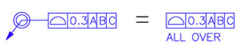

3i. ALL OVER Modifier: (()).
What: A new graphic symbol can now be used in place of a note.
Where §3.3.25 p.44 + §8.3.1.6 p. 161 Fig. 8-8 p.163.
Objectives: To replace a note with a symbol.
Ratings: usefulness [questionable]
The 2009 Standard allows use of a newly introduced symbol to represent an ALL OVER Surface Profile requirement as shown in the drawing above, and includes a leader. Because the concept of ALL OVER does not apply to any particular feature of a part, but to all not otherwise controlled features, a leader seems unnecessary. Thus a stand-alone Feature Control Frame with the words ALL OVER may well remain the common implementation and is fortunately still permitted.
