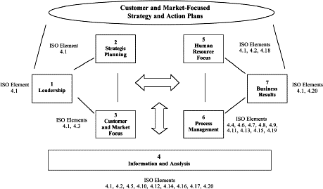

Mapping the Baldrige criteria to your QMS
Most organizations with an existing ISO 9000-based QMS document their quality systems according to ISO 9001's 20 elements (or ISO 9002's 19 elements). To expand a QMS into a BMS, it is first necessary to understand how to map Baldrige criteria to a current QMS. Figure 1 provides an overview that contrasts the Baldrige Award categories with ISO 9001's elements.
Figure 1: Baldrige Criteria for Performance Excellence
Framework vs. ISO 9001 Elements
BaldDirk3

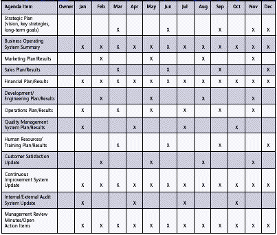

Management responsibility (ISO 9000 element 4.1) has a greatly expanded role under a BMS that focuses on leadership, strategic planning and tracking of key measurables. A traditional approach to the management review process is to conduct an annual, semiannual or quarterly review of the QMS by element, but a more integrated approach to management review is to cover the elements of ISO 9000 during monthly BMS reviews (see Table 1).
Table 1: Management Review Agenda Matrix
bald1

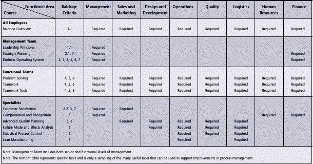

During the assessment, attention should also be given to the organization's training needs. A training matrix shows most of the training that personnel may need to support the implementation effort and indicates which functional areas will be impacted (see Table 2). The additional training will be focused on three broadly defined groups within the organization. The first group is the management team, whose training emphasizes leadership skills, strategic planning and the creation of a business operating system. The second group includes the organization's functional-area personnel, whose training teaches teamwork skills, use of teamwork tools and problem solving. The third group comprises the specialists within the organization, whose training supports process management improvement efforts.
Table 2: Training Matrixbald2
Once team structure and guidelines have been defined, training should be conducted to support the teams as they work to become high-performing teams. This training should begin with the senior management team, but eventually should be provided to all teams. Specific training should be conducted just before it's needed to support a part of the implementation plan.

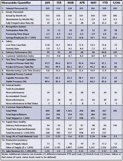

Business operating system
The business operating system is the process used to track performance as an organization strives for excellence. Goals and targets identified during the strategic planning process should be reviewed on a monthly basis to ensure that the organization is performing as planned. Monthly reviews allow timely action to be taken where improvement is needed. Measurables that support the plan should be trended and compared to the goals and targets. This data can be recorded and be communicated to the organization (see Table 3).
Table 3: Business Operating System Summary
bald4
