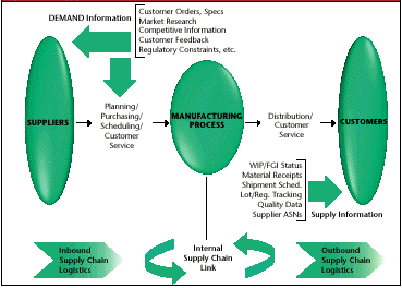

The most recent concept from the consulting community to improve productivity and achieve zero-latency manufacturing is supply chain management. Unfortunately, the fact usually overlooked in supply chain management discussions is that the manufacturing systems provide one of the most critical points of that supply chain (see Figure 1).
Figure 1: The Supply Chain
mes1
A manufacturing company is primarily concerned with three major links of the supply chain. The first link is inbound logistics, which includes all functions upstream from actual manufacturing and is focused on sourcing and preparing for manufacture. The second link is the manufacturing function itself, which is focused on facilities, equipment, labor, material and the process. The third link is outbound logistics, which is focused on finished goods and distribution. Although the inbound and outbound logistics links tend to be very customer- and order information-centric, requiring a great deal of information about customers, suppliers, orders and shipments, the manufacturing link tends to be very process- and production-centric. Whereas it has traditionally been easier to adapt and integrate information systems associated with the inbound and outbound logistics activities due to their alignment with ERP system functionality, it has been more difficult to adapt and integrate the manufacturing component because of its dynamic nature and uniqueness from plant to plant.

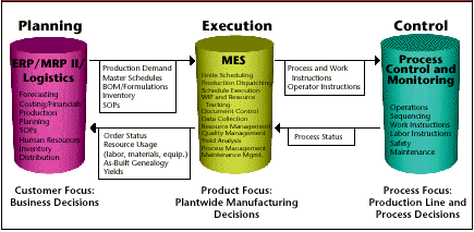

Appropriate application of MES tools is also necessary to enable companies to maximize return on their ERP/supply chain management/advanced planning and scheduling investment by providing accurate, timely data and closing the loop between plans and actions (see Figure 2). Imagine spending millions of dollars on a fighter jet but forgetting to put in any instruments for determining speed, altitude, location or fuel level. Doing that is much like spending tens of millions of dollars on an ERP or supply chain management implementation, only to leave it starved for information needed from the MES layer.

An MES provides the real-time visibility of all plant data so that scheduling and planning software can optimize it. MES tools provide a meaningful relationship between business data and factory data. Communication between control equipment and personnel via device servers and customized graphical user interfaces provides a decision-making foundation that permits users or operators to concentrate on solving their operational issues and problems. An MES provides real-time decision-making support to production and quality management, synchronizing all of the resources and activities on the shop floor.
The appropriate application of information technology offers a number of quantifiable business benefits by optimizing the manufacturing process, increasing the process' responsiveness and flexibility, and reducing the cost of information. Effective MES implementations have been shown to provide dramatic return on investment. Equally important, they provide an infrastructure designed to accommodate change, be it externally induced (as by new regulations, changes in the market or customer demands), internally driven (as by corporate improvement initiatives, ongoing cost control efforts or process redesign) or technology-driven (as by new systems or new platforms).
The real key to an MES is that the system automatically interfaces the shop floor control layer, which is manufacturing the actual product. Thus it is the ideal vehicle to automatically collect any data needed for or by any other information system in the organization, including quality; document management; maintenance management; materials management; and time, attendance and labor management. An MES provides a plant-resident, real-time total production database that correlates process data, product data and order data. This provides for total product traceability while providing a continuous improvement platform for plant operations. An MES allows users to quickly answer questions related to quality, scrap, downtime or yields and to see the cause-and-effect relationships of product, process and materials.
